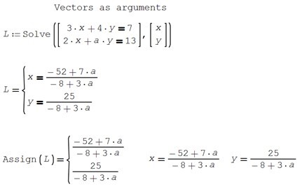

Hi, I ran into an issue trying to use Solve() function with Maxima plugin.
I installed the last version of plugin (5.45.1)
and even the refence book seems to not work properly:
Click to enlarge
although, when I remove the L:= it does solve again.
Click to enlarge
how could I resolve this issue?
regards,
#2 Posted: 12/23/2021 10:05:31 PM
1,080 likes in 1,752 posts.
regards,
Hi. Think of Solve's non-evaluation problem as something similar to what you get with Hold in Mathematica or with 'x' in Maple. I do not know if it is a change in the behavior of the plugin that is here to stay, or an unwanted effect due to an update, but what you can do is not define with := and ask in the same line for the symbolic result, but first define L := Solve (...) and then symbolically evaluate L ->
this means, SMath needs another step to proceed to evaluate the expression in Solve.
