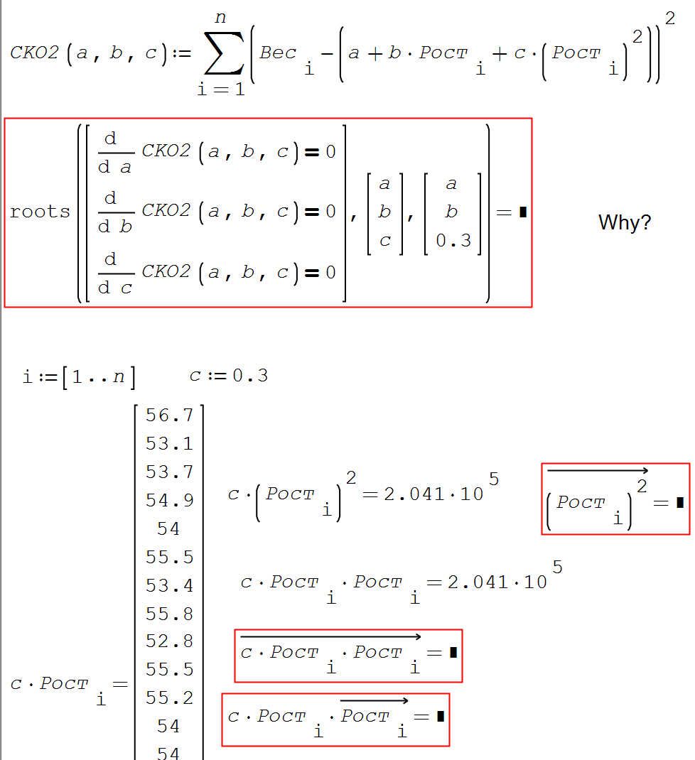

#1 Posted: 10/14/2023 3:31:44 PM
#2 Posted: 10/14/2023 9:38:32 PM
WroteSee please the end of the attached file.
Triplet roots ... FindRoot not doctored.
6-1-Mister-Class (1).sm (66.16 KiB) downloaded 1239 time(s).

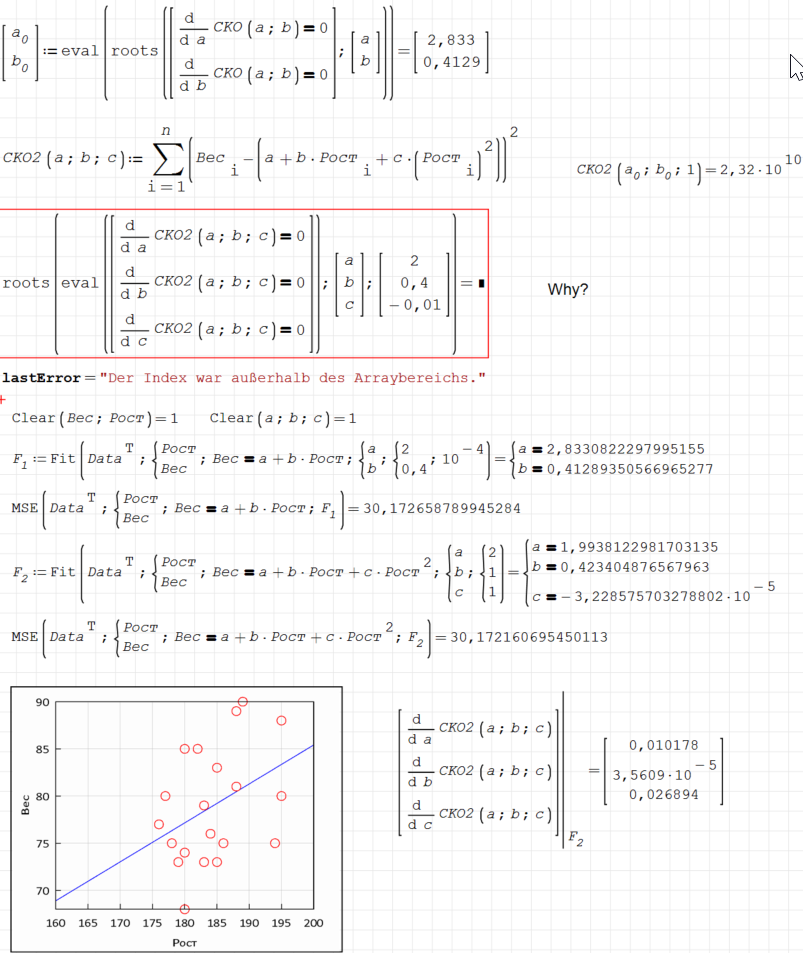

#3 Posted: 10/14/2023 9:42:14 PM
The first error can be handled by wrapping the function in eval(). For the second one this does not help.

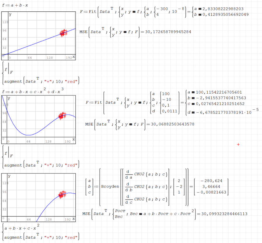

#5 Posted: 10/14/2023 10:52:25 PM
Hm, where exactly do you see the most severe сложности in the use of the Maxima plugin? Perhaps everything that needs a handbook is too complicated nowadays
I really like the curve fitting interface with the Fit() function, which might even be comprehensible from the подсказка in the dynamic help.
#6 Posted: 10/15/2023 12:19:13 AM
Hi. Polynomial fitting, returning the same values that Excel returns. From this post.
fit_CKO.sm (51.22 KiB) downloaded 1295 time(s).
#7 Posted: 10/15/2023 2:35:01 PM

Hi Valery. Martin showed why. But for the quadratic case Máxima's Fit function does not return the same result as Excel, which could be said to have been taken as standard, since they are also the same as those usually obtained with the 'all powerful' (talking about of gods) a\b of Matlab. I made the post to show how those mythical values can also be obtained in SMath.
Because SMath' solver isn't very powerful you can get those same values with your method using another, like the following one
About the error vectorizing, you can see why taking a look of this

There is not much sense in fitting functions with many degrees of freedom to data containing not much information. Any function which goes through the centroid of the data points will come up with a similar MSE.
Is the second result really the best just because of it's lowest MSE?

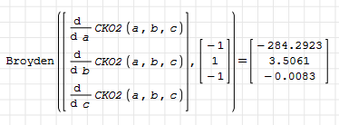

#12 Posted: 10/16/2023 12:33:28 AM
Valery, as it looks all doctored.
Thanks Alvaro for the robust Broyden.
Curious, Solver 30405 Slope/Intercept back on foot.

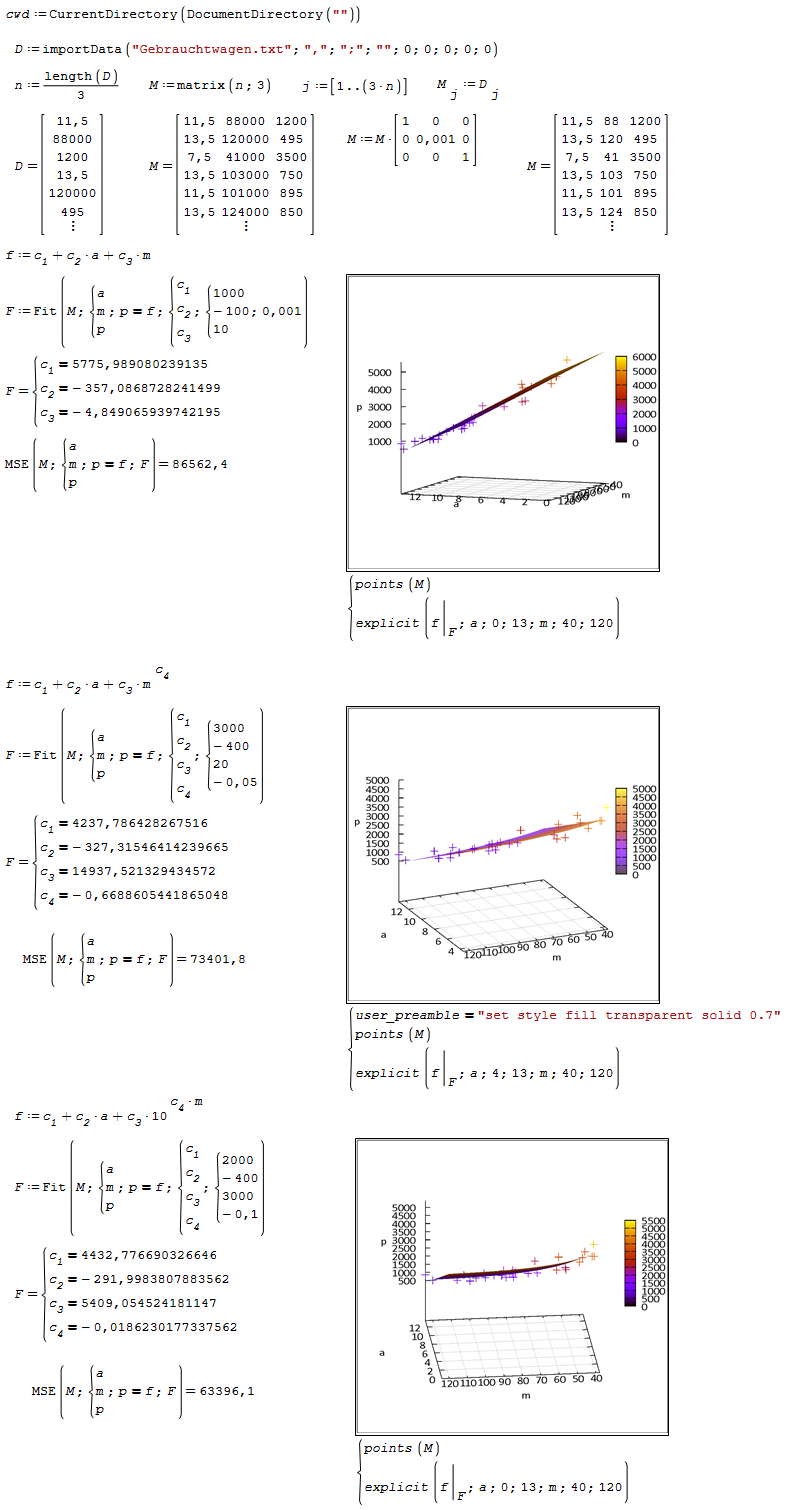

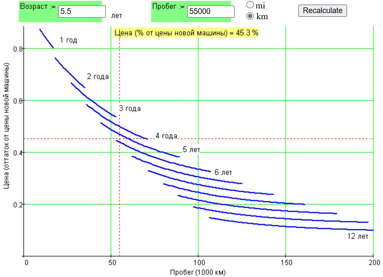

#13 Posted: 10/16/2023 1:06:59 AM
And what about 3D fitting in SMath?
See please my old problem in Mathcad
http://twt.mpei.ac.ru/ochkov/car/c_e.html
Online calculation

#14 Posted: 10/16/2023 5:57:28 AM
The second and third fit aren't really robust (quite some dependence on initial guesses)
Gebrauchtwagen.txt (729 B) downloaded 873 time(s).
Gebrauchtwagen.sm (90.47 KiB) downloaded 1287 time(s).

#16 Posted: 10/16/2023 12:48:56 PM
WroteAnd what about 3D fitting in SMath?
Online calculation
http://twt.mpei.ac.ru/MCS/Worksheets/old-car.xmcd
Another way, from the same previous post .
fit cars.sm (83.96 KiB) downloaded 1284 time(s).
#17 Posted: 10/16/2023 1:45:10 PM

The data is from your website. I copy-pasted the table to a new text file and imported it. Just use the files provided in my post.
As to the last plot: I guess the mileage limits of the individual lines are taken from the minimum and maximum slope observed in the age-mileage plot (fig.2 in your reference)?
Do you see any particular problem or do you just want the work getting done?

#20 Posted: 10/17/2023 12:58:58 AM
Global fit Cholesky
Frequently, you can manage the Phi vector for a best regional fit.
Project fit cars Cholesky.sm (19.75 KiB) downloaded 1248 time(s).
