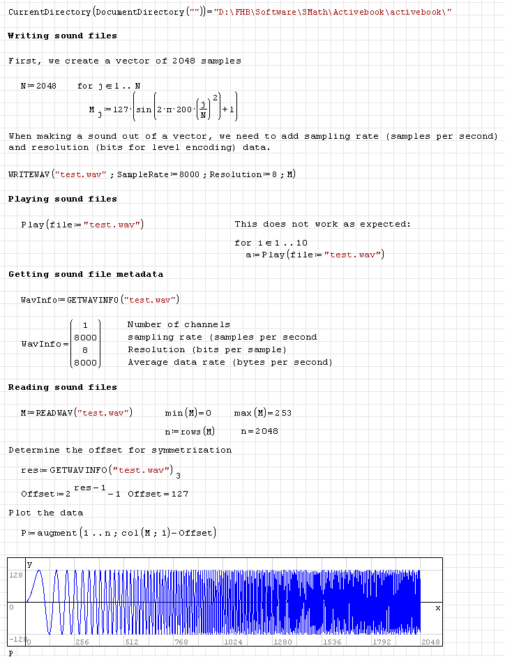

If there a way to write a file that plays music?
Give frequency, duration, etc.
Thank you,

Yes, see attached file.

#4 Posted: 4/24/2014 6:11:24 PM
1,532 likes in 1,846 posts.
Quote
This does not work as expected
MathcadFileAccess plugin updated. Try now.
Martin Kraska 4/25/2014 2:51:00 AM
