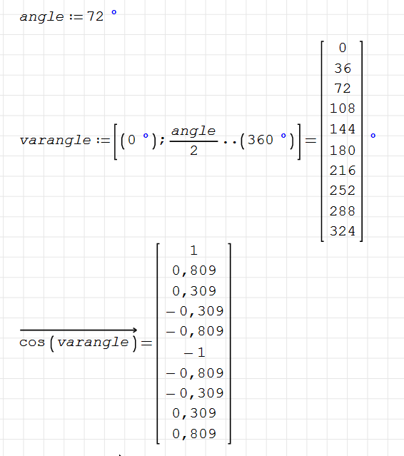

#6 Posted: 9/28/2024 2:44:50 PM
WroteCorrect me if i'm wrong, trigonometric functions don't support arrays currently.
For now, you can do something like this.
did arrays appear in trigonometric functions?

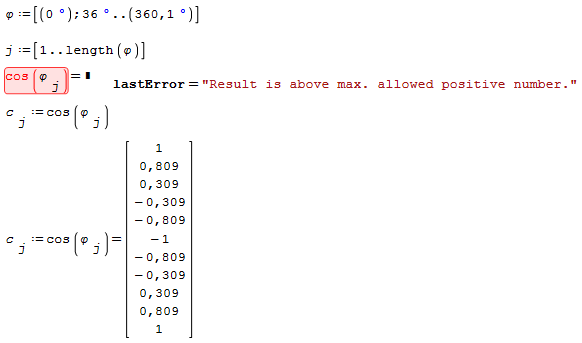

#8 Posted: 9/29/2024 10:22:50 PM
An alternative to the vectorize() function is the use of index vectors.
They, however, only work if they are used in a definition.
Worksheet1.sm (5.28 KiB) downloaded 1426 time(s).
