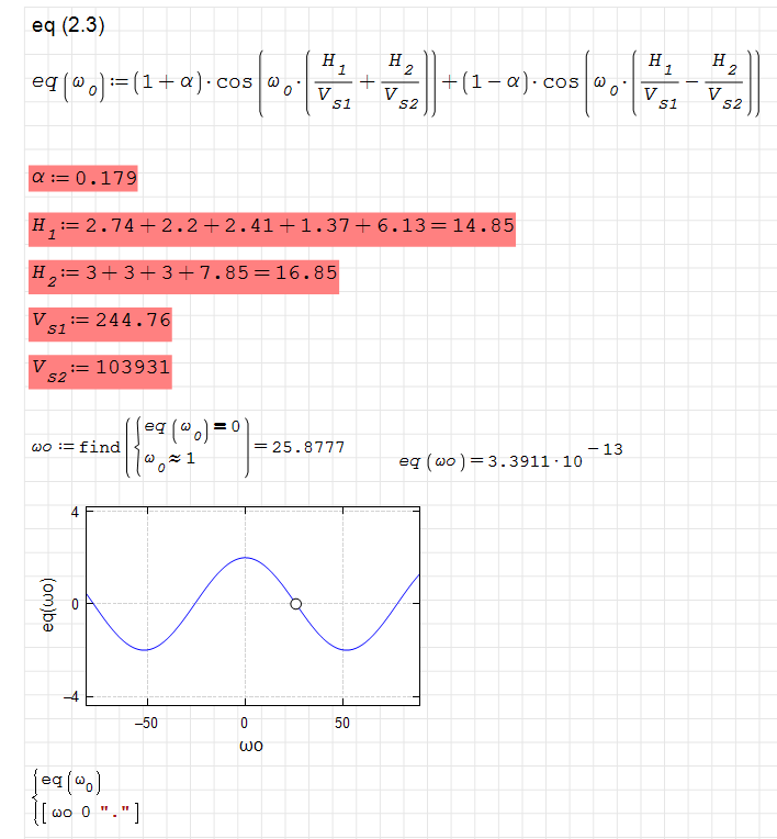

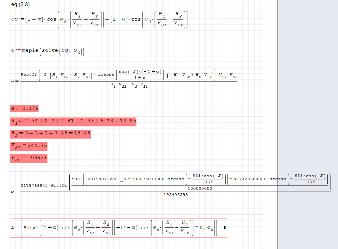

SMath Forum SMath Studio Questions solve problem 1 Pages (2 items) solve problem - Messages Go to last post #1 Posted: 7/30/2026 8:47:00 AM soomoon 1 likes in 42 posts. Group: User I'm working on in SMATH.I am not certain how to solve.Attached is my worksheet.RootOf.sm (12 KiB) downloaded 292 time(s).I welcome any help to solve this.Thank you, #2 Posted: 7/30/2026 9:10:23 PM Вячеслав Мезенцев 1,555 likes in 1,867 posts. Group: Moderator The solution is periodic, numerical methods can be used. Russia ☭ forever, Viacheslav N. Mezentsev 4 users liked this postsergio 7/31/2026 10:49:23 AM, NDTM Amarasekera 7/31/2026 12:56:30 PM, Alvaro 8/1/2026 2:55:58 PM, ioan92 8/5/2026 7:40:05 AM 1 Pages (2 items) New Posts No New Posts
