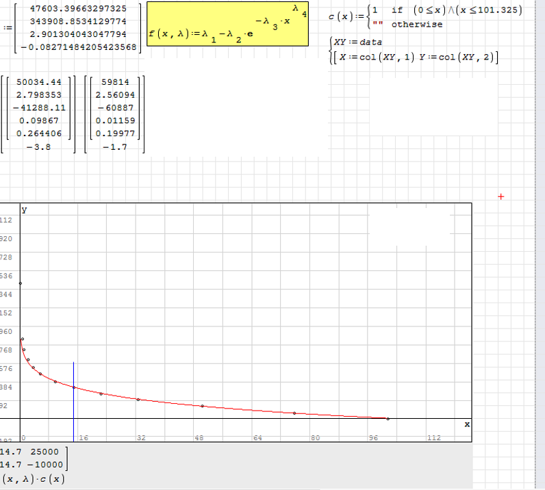

#4 Posted: 6/2/2019 7:32:58 PM
Revisit/resume km_kPa ... from several proposals:
1. Thiele two segments
2. Transmute modified Carlos
3. Wolf-Rabbit two segments
4. HKL [simple/corrected]
5. Exact_4 [± 0.001 m ... 0 m up ~ 11 km] <= ! ! !
Inst_ISA [km_kPa] solve NASA Reconciliate Copy.sm (137.46 KiB) downloaded 1008 time(s).

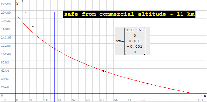

#6 Posted: 6/4/2019 12:51:38 AM
Hello Jean
This is another approach
Thanks Carlos, tested page 13.
The all range [0 .. 101.325 kPa] ... [0 .. 60km]
resumed in 4 segments of same format, zero error page 11, 12
NASA is short of accepting @ 60 km, pressure still exists !.
Inst_ISA [km_kPa] solve NASA Reconciliate.sm (196.66 KiB) downloaded 1094 time(s).

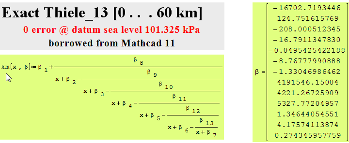

#7 Posted: 6/4/2019 9:00:35 AM
... final reconciliation pages 14, 15
Tiele 13 terms converted to J continued fraction
Just a peanut ... truncate β at will, reasonably, checking Δm.
Inst_ISA [km_kPa] solve NASA Reconciliate.sm (215.38 KiB) downloaded 1069 time(s).
