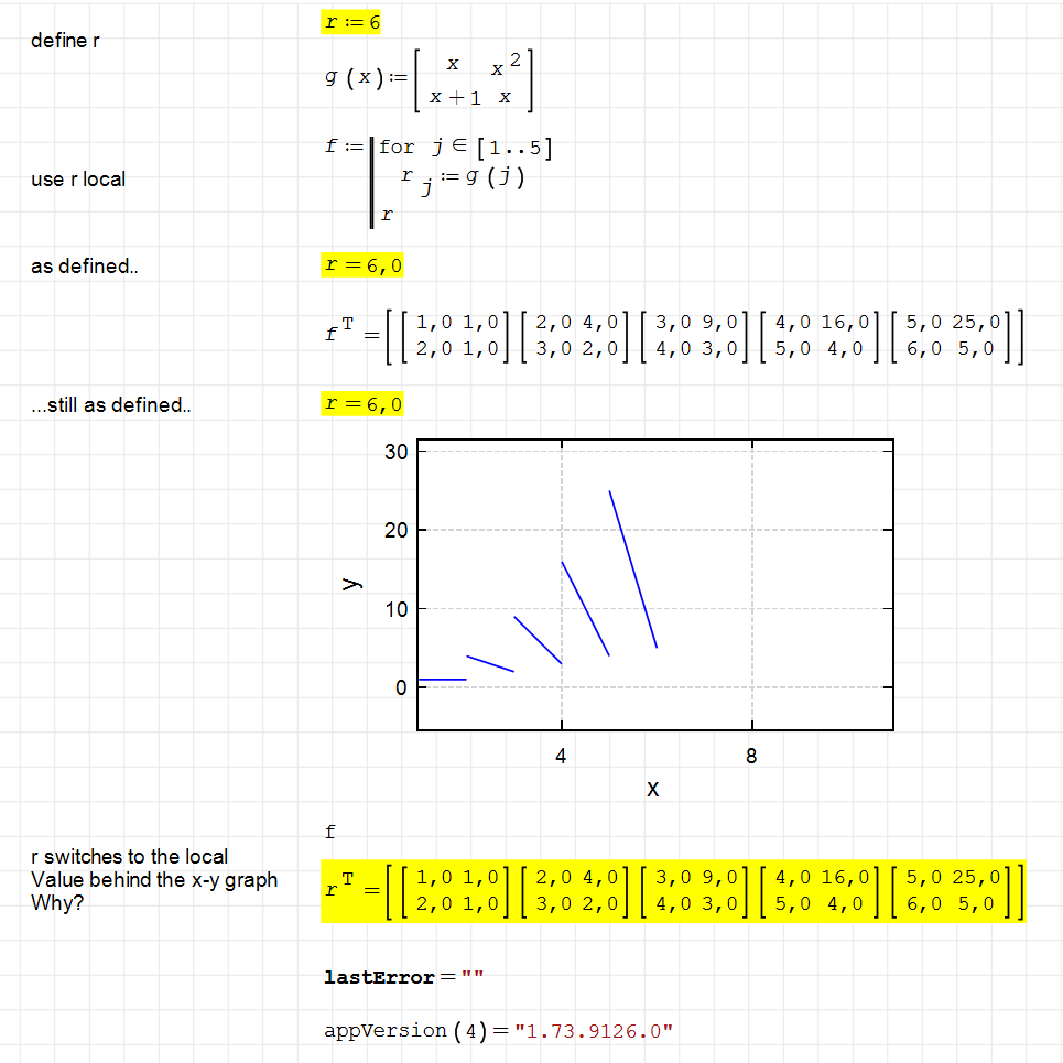

SMath Forum SMath Studio Bugs & Problems bug in x-y graph? 1 Pages (2 items) bug in x-y graph? - unexpected value change - Messages Go to last post #1 Posted: 3/20/2026 1:11:26 PM Johannes Piel 2 likes in 20 posts. Group: User Hi everyone,I've noticed some strange behavior: a variable changes its value after the x-y graph is loaded.Maybe you could tell me if this is a bug or a feature...Best regards and have a great weekend!Johannes [xygraphBUG.sm (11.45 KiB) downloaded 421 time(s). Edited 3/20/2026 1:27:46 PM 1 users liked this postВячеслав Мезенцев 3/20/2026 9:25:04 PM #2 Posted: 3/20/2026 4:51:56 PM Вячеслав Мезенцев 1,554 likes in 1,864 posts. Group: Moderator Yeah, it looks like a bug. The behavior isn't very good. I'll see what I can do. Russia ☭ forever, Viacheslav N. Mezentsev 1 Pages (2 items) New Posts No New Posts
