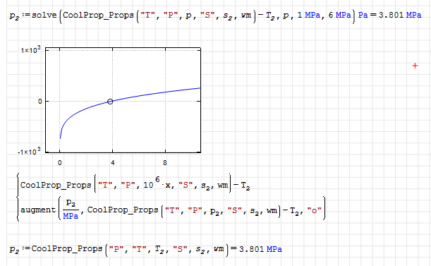

Take care :
Your CoolProp function, as you write it, does not change the sign, between the two limits of the variable p :

The problem, as you formulated, seems as not having a solution in real numbers, in order to be solved with the solve routine.
I'm sorry but I have no time to reformulate your problem.
If you intend to solve it numerically, try to check the continuity of the function and the fact that in the range you look for solution there is at least one change of the function value sign.

Hi. The guess values, in this case the range, are part of the solution, this means that you must know where the numerical procedure works fine. In this case the interval 1 MPa ... 6 MPa.

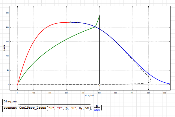

It works! By p.0=240 atm
Fireless-Locomotive.sm (882.15 KiB) downloaded 1607 time(s).
But by p.0=140 atm ---???
