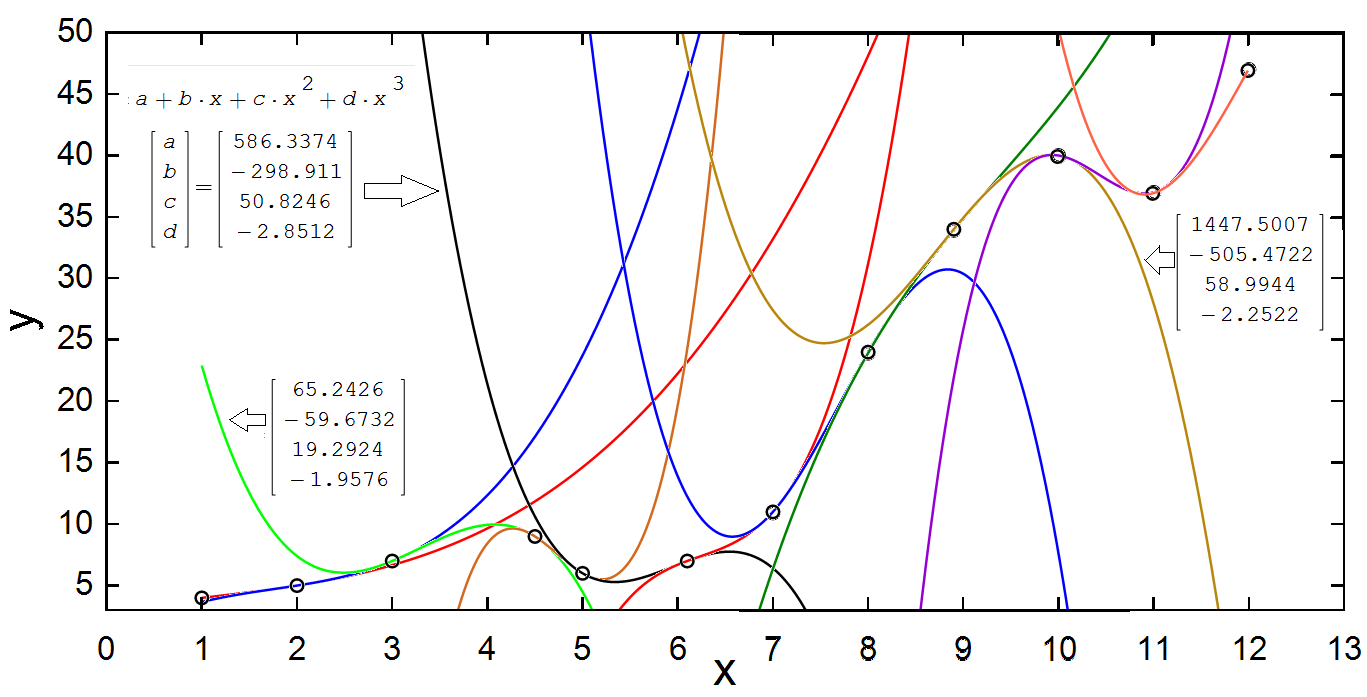

As a temporary solution:
Click to enlarge
linterp-xyplot-using-defined-argument.sm (21.7 KiB) downloaded 1468 time(s).
interp(), ... functions from Mathcad Toolbox still have a bug. The implementation used does incorrect interpolation on some intervals. I don't know how to fix this yet, because the algorithm was restored according to the article and perhaps it was done incorrectly.

Is that bug only related to non-equidistant points? In that case, the functions would still be good enough for the ode solvers, at least for rkfixed()
#7 Posted: 12/12/2023 7:56:30 PM
Is that bug only related to non-equidistant points ?
The lspline(X,Y) produces the wrong vector
k ... [0 3 0 0 0.6629 ...suite OK]
k ... [0 0.6629 ...suite OK]
Put the right vector in interp(k,X,Y,x) fails.
Simply a bug ... reflexive double bug.

Hi Viacheslav. It seems that the Mathcad lspline actually it is a cubic spline. That as conclusion comparing lspline with the maple spline function. Thus, it has the Martin's restriction: x values must to be equally spaced (but that is not required for maple algorithms). Actually, that's looks like the best option for working with ODE's, especially for boundary conditions about the derivative of the spline function.

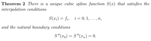

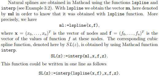

I will remind you of this document, which describes how the functions work. My implementation of interpolation has an error, but the coefficients themselves seem to be calculated correctly.
In Mathcad the first three numbers encode the type of spline. Jean doesn't know about this.
Cubic spline interpolation using Mathcad (2009).pdf (256.71 KiB) downloaded 2653 time(s).

#12 Posted: 12/13/2023 2:58:24 PM
Hi Viacheslav.
Yes, my comment is about that the lspline and pspline names could be sort of confusing, because, as the report says, mathcad's lspline, pspline and cspline are all "cubic splines". The "l" in "lspline" is not for linear interpolation, but for linear ends conditions, also called natural conditions. The "p" is for parabolic, and the "c" for cubic, all meaning ends conditions too.
Thus, Mathcad lspline is not related with SMath linterp or maple spline(X,Y,x,linear)
