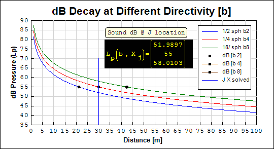

WroteI can work with dB in Mathcad 15. How to work with dB in SMath ?
Simple example attached.
Cheers ... Jean.
Inst_dB Sound Copy.sm (142.11 KiB) downloaded 1216 time(s).
dB.sm (9.61 KiB) downloaded 1143 time(s).

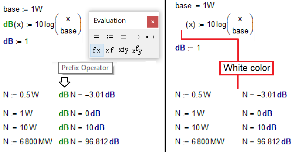

but how can I see your plot without any formatting?

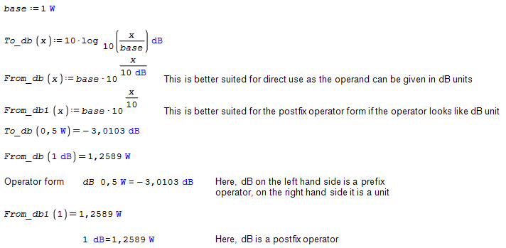

WroteIf Davide could provide operator forms for To_dB() and From_dB() then this could pretty much look like in Mathcad.

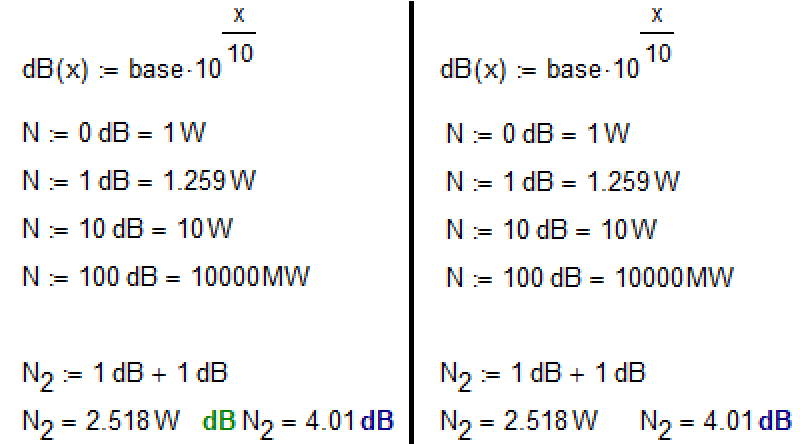

Thanks,
But how can I use the postfix and prefix operators in SMath? Is there a tree operator too?
Wrotebut how can I see your plot without any formatting ?
Try to zoom your document in native Smath 100 %
WroteWroteIf Davide could provide operator forms for To_dB() and From_dB() then this could pretty much look like in Mathcad.
Thanks,
Davide Carpi has defined operator representations for some functions in his Custom Glyphs plugin. So he is the wizard who can make that happen if you convince him. He also implemented the Glyph for the Maxima().
The drawback is that users can easily read these expressions but it is hard to guess how to write these operators if you aren't aware of the background function used for it. So the best would be to have a side panel (as it is implemented for the currency units plugin).
WroteWrotebut how can I see your plot without any formatting ?
Sorry, but same result.
WroteSorry, but same result.
Seems something related to DPI scaling in the plugin. Just a guess.
WroteOriginally Posted by: Jean Giraud [/url]Originally Posted by: OchkovVF [url=/forum/yaf_postsm81092_dB.aspx#post81092]but how can I see your plot without any formatting ?
Rewrite the code on your system.
