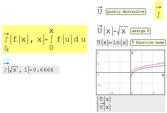

You can slide any decoration over a variable name
... or over a function definition ... even an arrow !

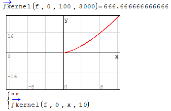

You can have some circomflex hat as well from Charmap.
All or most Charmap can bear function name, even single arrow.
Take care Basile ... old Collab ... Jean.
#10 Posted: 5/7/2023 2:26:16 PM
... the document for eventual projects.
Cheers ... Jean.
Maths Symbols DECORATION Copy.sm (17.26 KiB) downloaded 1267 time(s).
