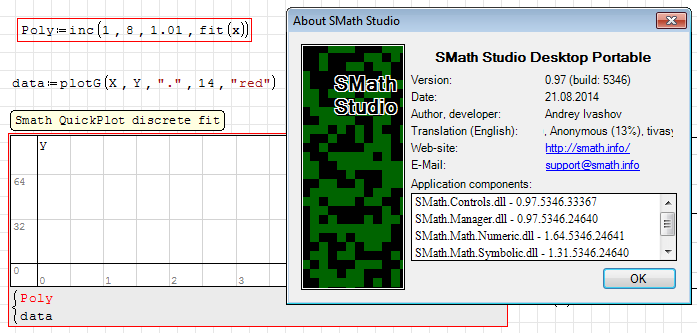

CBG's format worked great for me (Thank you). I was going through my MathCAD sheets/notes ...Curve.PNG

Just one character fixes Jean's excellent (as usual) sample:

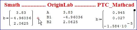

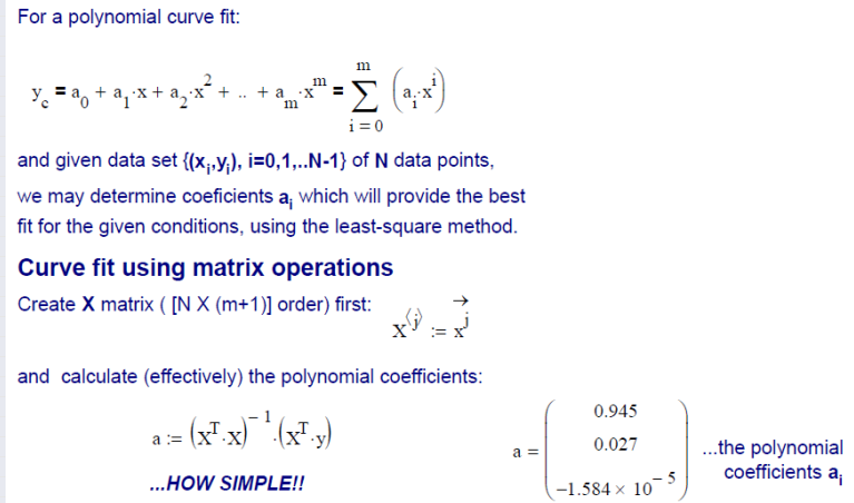

#7 Posted: 4/19/2016 7:08:27 PM
Your Mathcad coding is pure invention. It can't be otherwise than
it was Mathcad 8/11. Where does that big blue note comes from ?

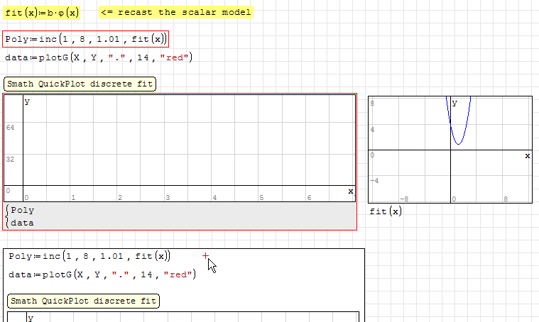

#9 Posted: 4/19/2016 7:22:53 PM
in poly:=, the function needed to be f(_x)
Thank you for pointing out where was the issue (and Jean for the code and Mike for the debug too)
In fact is not a problem of SS version, I opened the file attached by Jean with 0.97.5346 and I got the same error.
Still, I see the screenshot of Jean and I don't understand how it is possible that worked for him.
I'm not sure he had x defined above the screenshoted region at the time of screenshoting
С уважением, Михаил Каганский
Davide Carpi 4/19/2016 7:57:00 PM
#12 Posted: 4/19/2016 8:00:10 PM
Good point (it may happens with auto calculation disabled). I think he have to download and evaluate his own attached worksheet and confirm if is still working or not.

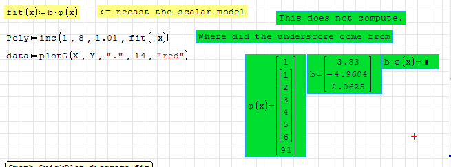

I am look at the fixed file from Mike and comparing it to Jean's original file. The only difference I see between them is the underscore in the function f(_x) in the Poly definition. Totally lost with the
  1. Why the underscore made it work?
  2. What the recasting of the scalar does?
#14 Posted: 4/19/2016 11:11:19 PM
Mike Kaganski
Mike Kaganski
184 likes in 434 posts.
Yes, that's exactly that one character I mentioned above
Quote
  • Why the underscore made it work?
  • Because the "_x" is undefined. Jean used function-as-parameter feature to pass an algo to a function. SMath requires that in this case, the passed function (here it's f(#)) must have its fictive parameters all previously undefined variables. This is very old requirement (I'm unsure if there ever existed a version without it). As Jean has defined "x" above, it coudn't be used as fictive parameter to passed f().

    Hello Collabs ,

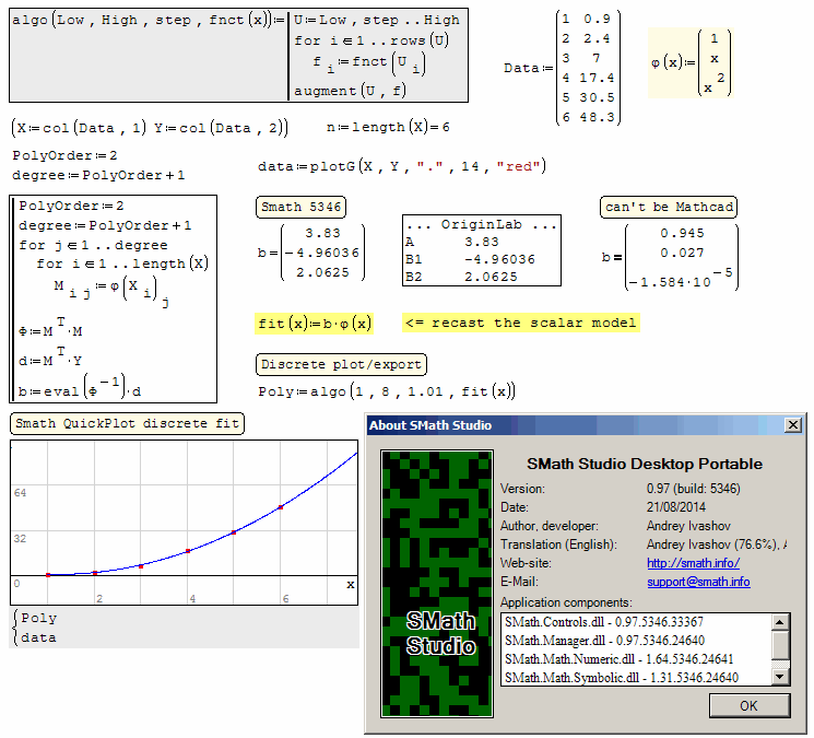

    Here is the screen shot of the attached work sheet.
    My installed Smath 5346 is "as is" from the day it was installed.
    No download update. Why the underscore would make it work on Elsid
    version, can't explain. From what you are saying Davide, it looks
    that if some of the "nightly build" reside in the same machine, it
    broke logical link to user define function, or code incompatibility
    between versions.
    Poly Quadratic 5346.sm (38.23 KiB) downloaded 1235 time(s).

    Your Mathcad coding is pure invention. It can't be otherwise than it was Mathcad 8/11. Where does that big blue note comes from ?
    Jean, The Mathcad file I posted in blue does NOT use the same data points, so the polynomial coefficients "b" will be different. I was trying to copy the syntax over to SMath

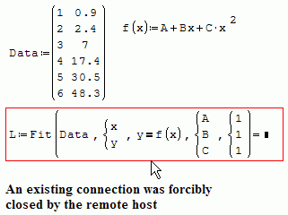

    The Maxima plugin provides the function Fit(), see the interactive handbook for details.
    Davide Carpi 4/20/2016 12:35:00 PM
    #19 Posted: 4/20/2016 12:57:30 PM
    Hello Martin,
    Very interesting, but does not work in 5346.
    Your work sheet does not work either.
