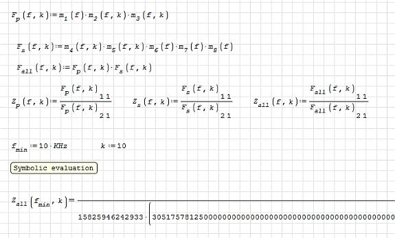

hi,
I'm a beginner
I get an error in the calculation
error :
result is above max. Allowed positive number
How can I solve it?

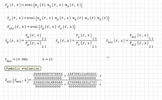

Change your calculation result from symbolic to numeric.
You can do it with eval() since they are all numbers.

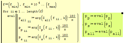

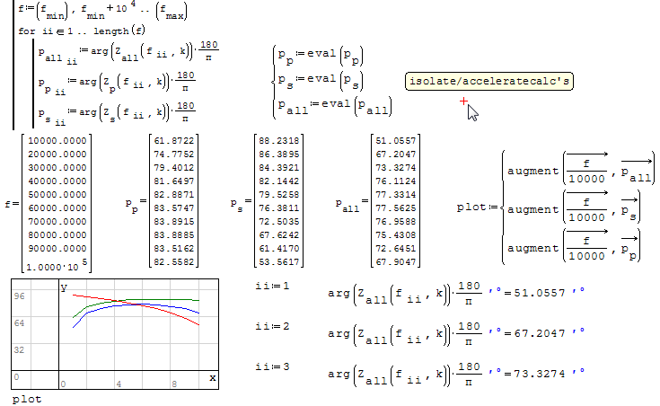

#5 Posted: 5/28/2021 8:33:21 PM
Good application case to globalize within the program.
... in my SS 6179 timing drops from 2.6 s down to 1.6 s

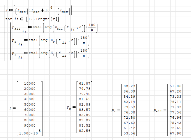

Hi Takez. Yes, it's very difficult recognize or even guess where the program needs some evals. Also, putting them everywhere make unreadable the procedures. In the case of your PPS.sm that's SMath stores into Z without eval
and this with it
So, for PPS.sm there is where you need to use eval, and seems that then all other calculations works.
