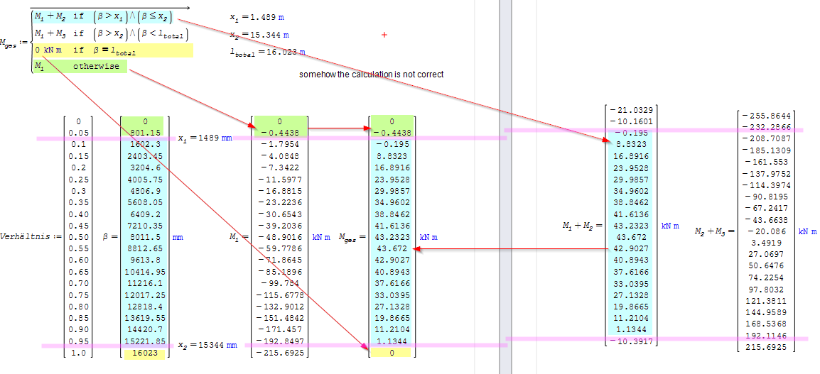

Hallo guys,
i prepared my calculation but i i am not sure if i can define my bending moment in such a way
Special look on the field moment i made
M1+M2 for
M1+M3 for
0 if....
M1 otherwise
is this correct?
thank you br Stefan
Test.sm (75.28 KiB) downloaded 796 time(s).

i do consider some problems i think this math code is not correct

I'm not sure what do you expect, but the values are assigned according to your logic

ok thank you it seems to be correct !
