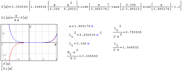

I am receiving an error which I did not receive in prior versions. The error is diff( , ) not defined.
Please excuse the crudeness of the attached calculation, it is an old version...
Any thoughts? Thanks!

no issues here.. May be related to the Maxima plugin?

I had to (geek) uninstall and reinstall the latest version. Then it worked fine. Someone else disabled Maxima and that also worked.

To me, the problem relates to units.
