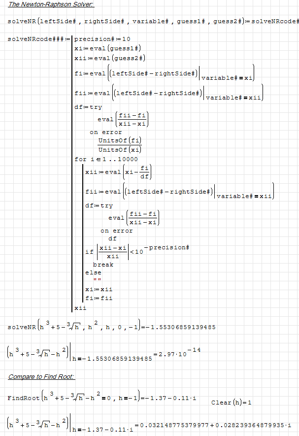

I figured I am not the only one who can benefit from a simple numeric solver that "just works".
It will likely become obsolete once Davide updates the Nonlinear Solvers plugin.
Enjoy.

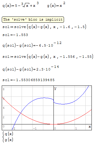

Interesting, but good thing Smath 5346 does it as well
w/o all that complexity. Shouldn't it be constructed
around "While" loop ? Remember that any invented iterative
solver for Smath can't exceed better accuracy than around
12 decimals because of the granularty of Smath.
The native Smath 'solve' has a universal structure wrt:
1. is implicit
2. the bracketing [x1,x2]
3. very easy to handle.

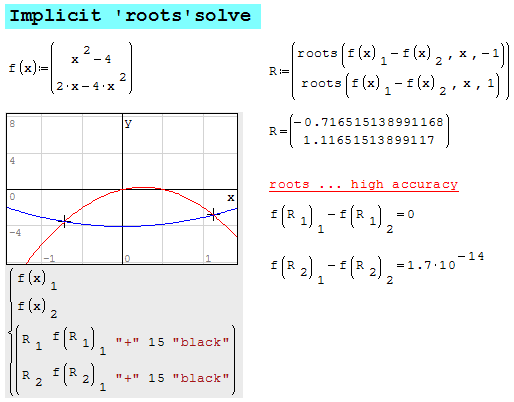

Alex,
The Newton-Raphson code in your first post would
surely work here in two cumbersome presentations.
For this example, 'roots' is a better candidate.

If only either of the two could handle the units I would not need to go through all the trouble. They do not, hence I had to get inventive.
