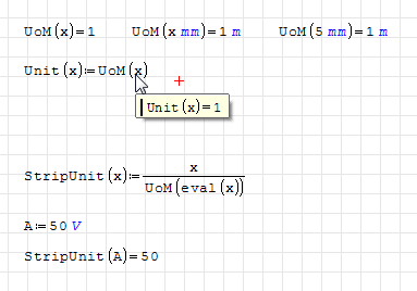

When I try to use UoM() in one of my own user defined functions it doesn't seem to work., Any ideas?
I am trying to use UoM to strip the units off a figure
eg StripUnit(x):=x/UoM(x)
x=50V
StripUnit(x)=50V
Or even more simply
Unit(x):=UoM(x)
Unit(50V)=1

UoM was designed to act in a generic way both with symbolic and numeric data... when you use it in a inline function, since x is unknown, his unit is 1 (dimensionless - hold the mouse over the definition); if you want to use it in a inline function you have to use Units(x):UoM(eval(x)). In programming functions (when you use line), eval in the argument is not needed, because the evaluation of UoM(x) is made when you call your function.

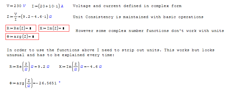

The background behind my query is that I use complex number calculations a lot for electrical engineering. Smath handles units well for basic complex number calculations but certain key functions do not work with units (Arg(), Re() and Im()) in particular). You can get around this by dividing off the unit but this looks inelegant and needs to be explained every time I show the work to someone. I hope to write my own user defined functions to replace them and having a UoM() function is a nessecary step.

Jean here is an example showing what I mean. The functions Re(), Im() and arg() don't work when the operands have units.

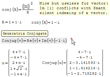

There is more than unit problem. I don't use unit
maths are unitless. BUT I append result in "UnitProject".
Years long fight in Mathcad, conclusion from collabs:
"Jean is right". ISO, Engineering ... formulas are given
wrt the unit system. Revisit the "Visual Graphic" example
just reposted this morning.

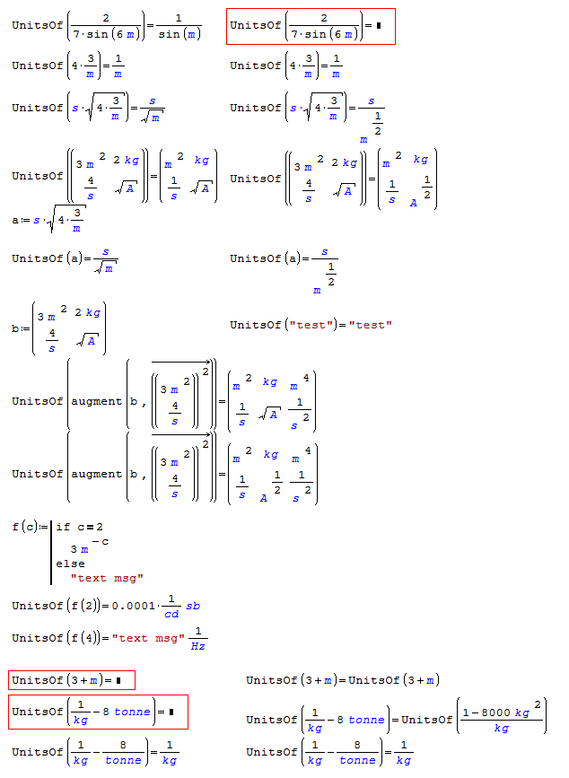

FYI: New build will contain UnitsOf(..) function which returns units of specified expression.
The following file created to test its most important use cases:
