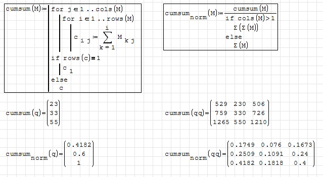

There's a simplest way to do this, without write [MATH]sum(el(q;k);k;1;1)*Q^{-1}[/MATH], ecc. in T matrix?
[MATH]q:mat(23;10;22;3;1)[/MATH]
[MATH]n:3[/MATH]
[MATH]Q:sum(el(q;k);k;1;n)[/MATH]
[MATH]T:mat(sum(el(q;k);k;1;1)*Q^{-1};sum(el(q;k);k;1;2)*Q^{-1};sum(el(q;k);k;1;3)*Q^{-1};3;1)[/MATH]
[MATH]T=mat(0.4182;0.6;1;3;1)[/MATH]

hi,
something like this?
here is the file in the image: m&s.zip

I tried just to add another variable, but program give me error.
I'm still not able. Thank you very much!
[MATH]n:3[/MATH]
Here's a possible alternative method ...
[albumimg]47[/albumimg]
