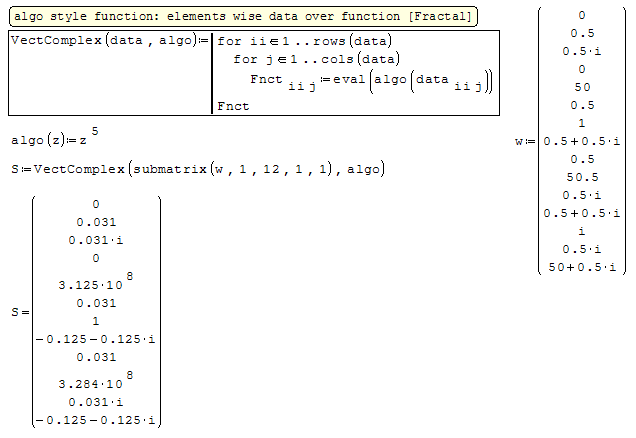

I recently discovered, that if I use vectorised operation on result of submatrix(v,...) and sort(v) functions,
vectorised operation doesn't work, it needs eval(submatrix(v,...)) and eval(sort(v)).
The optimization of the code is, of course, NUMERIC.
Another thing that happens, if I use NUMERIC function, returning something like mwexp(vector),
further SYMBOLIC calculations don't work with the result. I need to specify return value as eval(mwexp(vector)),
then it's OK. It might be intended behaviour, but it looks a bit fishy.

WroteI recently discovered, that if I use vectorised operation on result of submatrix(v,...) and sort(v) functions,
Vectorize function will not work for functions which requires matrix/vector as argument only. We have briefly discussed it here: http://en.smath.info/forum/yaf_postsm30971_SMath-Studio-0-98-5908--05-March-2016.aspx#post30971. As you see for now I have advises not to implement exceptions for such functions. That is why you need to use eval() there.
...IgorWroteI recently discovered, that if I use vectorised operation on result ofsubmatrix(v,...) and sort(v) functions,
In Smath, many types of result must be transited, particularly chained functions.
Andrey, any thoughts on implementing the symb() alternative to eval()?
It could be useful with vectorize() to complete the loop (numeric / symbolic).
