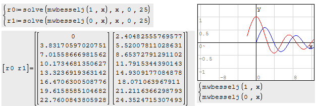

Dear Jean,
thank you for the answers.
To be sure if I understand right: the mistakes are from the approximation of the functions.
I apoligize, but I don't understand your "sanity check". Could you explain a little bit?
Thank you
Thank you

Often, in advanced works, we have to check [sanity check]
results. Casio [Keisan] on line calculator(sss..] is Bible.
As the matter example was Bessel: here is the document.
Link to Bessel-Keisan in turquoise.
Cheers ... Jean.
Bessel JY.sm (85.01 KiB) downloaded 1104 time(s).
