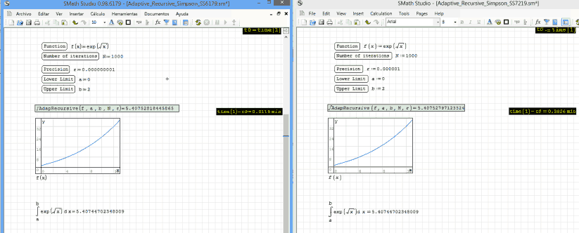

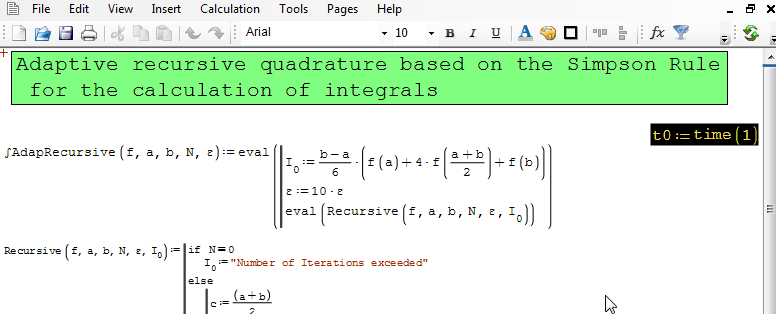

Here is an example of integration using the Simpson recursive adaptive method.
Adaptive_Recursive_Simpson_SS6179.sm (13.29 KiB) downloaded 1254 time(s).
On the other hand, when running the algorithm in the versions of Smath Studio 6179 and 7219,
I realize that the SS-6179 version is more accurate than the current SS-7219, since the
first one allows an error of 0.000000001, while the latter only allows an error of 0.000001
Adaptive_Recursive_Simpson_SS7219.sm (14.55 KiB) downloaded 1213 time(s).
The SS-7219 version cannot calculate the function with an error of less than 0.000001 to achieve greater accuracy.
Are we going back?

WroteOn the other hand, when running the algorithm in the versions of Smath Studio 6179 and 7219,
My native SS 6179 supports ε:=0.0000000000001
@ equivalent accuracy, Romberg-Simpson kernel runs ~ 8 times faster.
Most puzzling from version to version
On my slow laptop:
Romberg-Simpson ..... 12 s
Simpson recursive ... 96 s
Simpson kernel in Romberg range [0..1] at decimation [n]
is most valuable on large range of the integration variate 'x'.
Thanks Carlos, most interesting ... Jean.

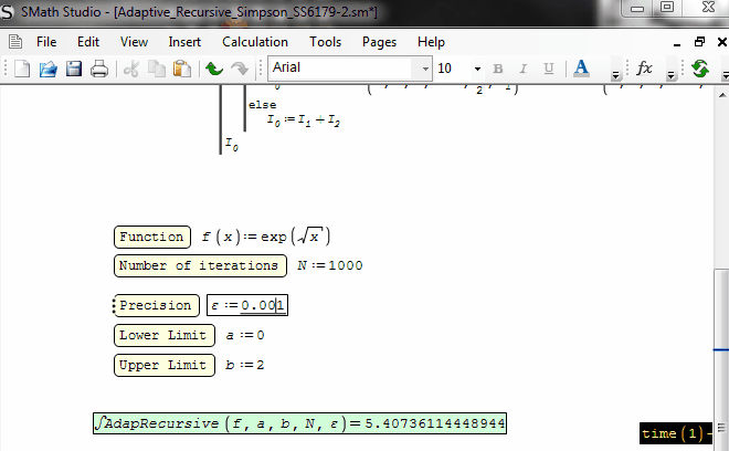

Strange thing happened to my Win7 machine (SMath 7219) and both files (by Carlos and Jean).
Running both files will just close SMath without any warning.
See this animated gif please.
This does not happen to my Win10 machine.

#6 Posted: 10/9/2019 11:35:47 AM
WroteWroteStrange thing happened to my Win7 machine (SMath 7219) and both files (by Carlos and Jean).
What about separate each integrator and run 7219 ?
I guess you have tried. So, your Win 7 is kookoo.
Hello Jean,
Int() is going well but AdapRecursive() makes SMath to shut down when decreasing epsilon on my "kookoo" Win7
