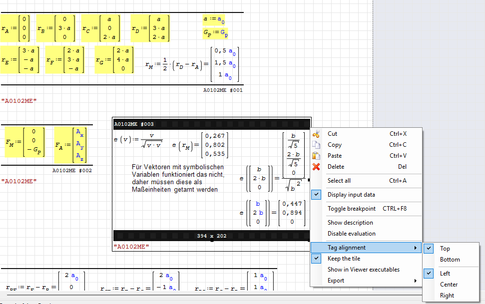

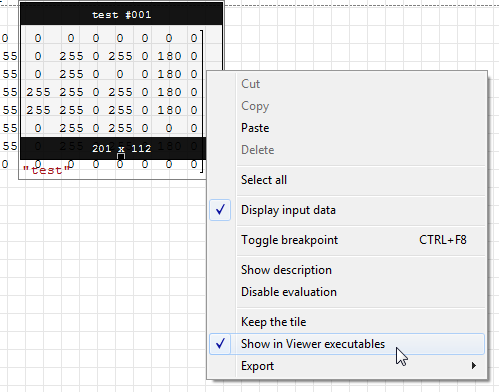

#55 Posted: 8/25/2017 1:11:01 PM
PLUGIN UPDATED (latest nightly build only)
  • fixed missing width/height settings on save/load;
  • plugin made available for SMath Viewer;
  • refactoring;
about SMath Viewer:
context menu now contains a new option "Show in Viewer executables";
if checked a button and a label are added in the viewer executable (default is not checked)
hoovering the button, a tooltip is available; the bottom text can be replaced by your own, using region's description (when available and shown in the worksheet).
clicking the button, a drop-down menu contains the image thumbnail, as well as the export options available in the worksheet.

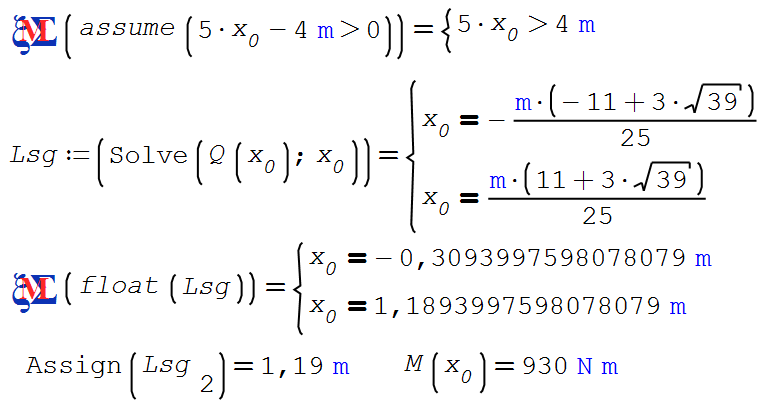

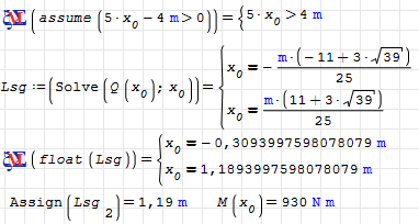

#56 Posted: 11/29/2023 8:06:54 AM
I am using the snapshot region a lot for producing manuals on SMath Studio (see https://extmoodle.th-brandenburg.de/course/view.php?id=138§ion=2). The workflow allows for quick update and corrections.
Regions copied via clipboard to Word or other programs have much better image quality than the snapshots produced with the snapshot region. Here is an example:
Would it be possible to increase the resolution of the screenshots? The clipboard copies seem to have double the resolution compared to snapshots. I'd be happy to have that resolution also in the snapshots.
2-2-neu.sm (133.18 KiB) downloaded 1520 time(s).
Oscar Campo 11/29/2023 11:00:00 AM, ioan92 11/29/2023 2:11:00 PM
#57 Posted: 11/29/2023 4:53:27 PM
I'll check it.

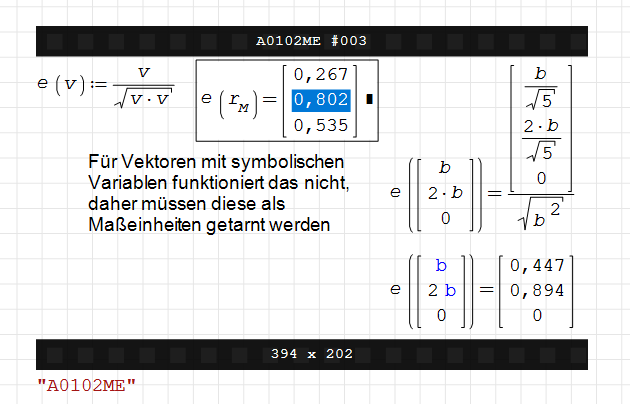

#59 Posted: 6/27/2025 9:11:34 AM
I'd like to rise again the proposal of some sort of "humble" style for snapshot regions, like in https://smath.com/en-US/forum/topic/SbW4Qx/Flexible-Export-to-image-formats#msg100816
I am currently preparing a book and want to share some of the examples in SMath in the cloud. For the book, the example files are full of snapshot regions. In the cloud version I don't like them because of their dominant formatting heavily impacts the appearance of the sheet. Therefore, I am finding myself continuously creating duplicates of the files where the snapshot regions are removed. That leads to increased workload when updating the examples.
Possible modifications would be:
- replace the two black bars by light grey thin lines (just like the region border)
- use the same light grey for the annotation (title, number and size).
Hiding the placeholder is possible from the context menu already.
The SMath roadmap promises to support third party plugins (as long as they run under Linux), thus it might be an option later to upload files with snapshot regions.
Edited 6/27/2025 9:17:07 AM
Alvaro 6/28/2025 5:08:38 PM
#60 Posted: 7/2/2025 2:21:12 PM
I propose a middle ground.
A "snippet mode" layout while the region is focused, a less intrusive layout otherwise.
Proof of concept:
(not available in the gallery, download and drag&drop on the canvas) SnapshotRegion.1_1_9315_25145.zip (34.53 KiB) downloaded 374 time(s).
Edited 7/3/2025 11:05:27 AM
sergio 7/3/2025 7:16:40 AM, Martin Kraska 7/5/2025 9:40:47 PM
