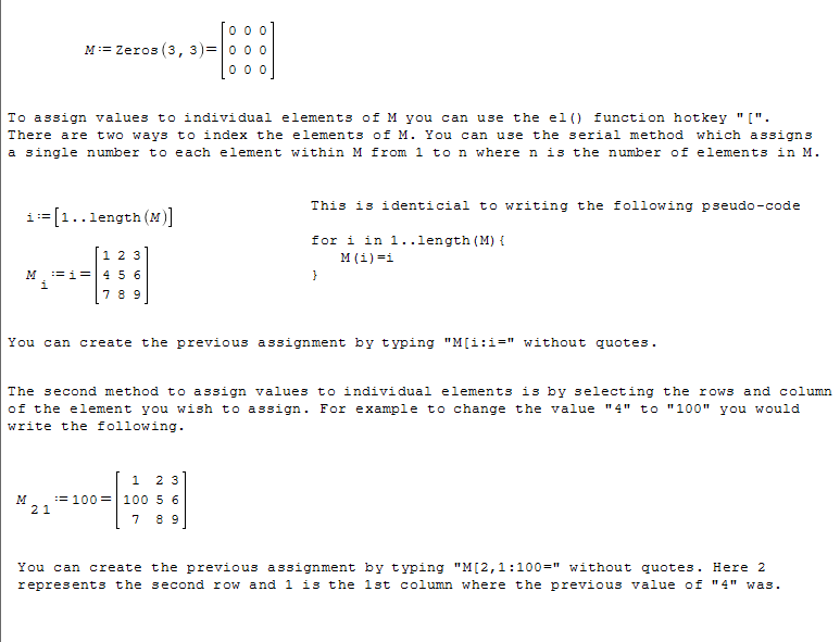

I have been trying to figure out keyboard shortcuts for SMATH.
I have been using these- https://smath.info/wiki/Keyboard%20shortcuts.ashx
Are there more? Can people add more to the wiki list?
For example, it would be useful to be able to matrix element assignemnts instead of always clicking the matrix panel to the right.
Is there a way to see the syntax to the panel buttons to figure it out?
Thanks in advance

#2 Posted: 7/10/2018 5:19:42 PM
QuoteFor example, it would be useful to be able to matrix element assignemnts instead of always clicking the matrix panel to the right.
Please take a look at the following file.
Matrix Example.sm (6.24 KiB) downloaded 1080 time(s).

#3 Posted: 7/10/2018 6:51:18 PM
alyles:
THANKS! The last bit is what I needed to get el(3) instead of el(2).
Dennis
