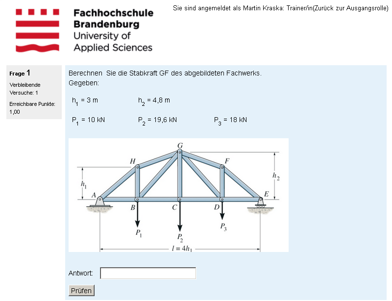

I am using Moodle for homework assignments in engineering mechanics. You can define problems with random individual parameters for each student and ask for a single number (with units support). This number is checked against a reference solution formula, given as a single expression without intermediate variables. Moodle takes care of deadlines, grading and the like.
These formula can be several hundred characters long, just imagine to compute the maximum stress in a compound cross section, where the centroid and moments of inertia need to be calculated from the given data. Kay had the job to create and input these reference formulae - guess what he did: writing a plugin for export of expressions to moodle format.
With interactive graphics at hand, I could imagine to ask for free body diagrams and support reactions with automatic consistency checking.
Or let the students draw shear and moment diagrams from randomly created loads and support conditions.
Or just create graphic problem representations based on parameters.
Moodle has a plugin interface and there seems to be a maxima plugin. However, I am not a moodle administrator and it was quite hard for me to find out how to operate it. The docs explain the buttons and dialogs but do not guide you through common workflows.
An interesting tool for such interactive graphics combined with computer algebra functions is geogebra. This is a tool which can be embedded in web sites, similar to SMath live. It is developed in Austria and in recent releases moves towards computer algebra.
Andrey, I agree that there is plenty of potential. However, for real impact, interfacing with a full featured course management and grading system is required and that is a project on it's own. Designing problems for such systems is considerable investment and one needs to be sure that the features in use are still working with the next moodle update.

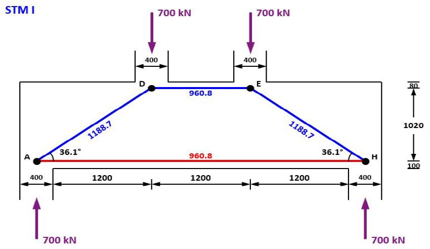

I know it has been quiet here for a while, but there is little something something I could use modeller for - strut & tie modelling:
http://best.umd.edu/publications/stm.pdf
or in plain words, conceptually separating a chunk of concrete into compression elements (struts) and tension steel rebar elements (ties) in a way that will create a valid load path from the point load to the support or reaction.
The thing with strut & tie is that it is very graphical solution; if you can draw it, it will work.
I was hoping to use modeller to draw a set of interconnected lines. Once drawn, the lines (start & end coordinates) can be extracted to SMath for further processing.
Modeller would be a perfect environment for this, except in it current form it cannot draw inclined lines, or lines that will "snap" to the existing node.
Andrey, do you anticipate any further work on this plugin?
Right now I am "drawing" in EXCEL and heck it is not right way of doing this.
