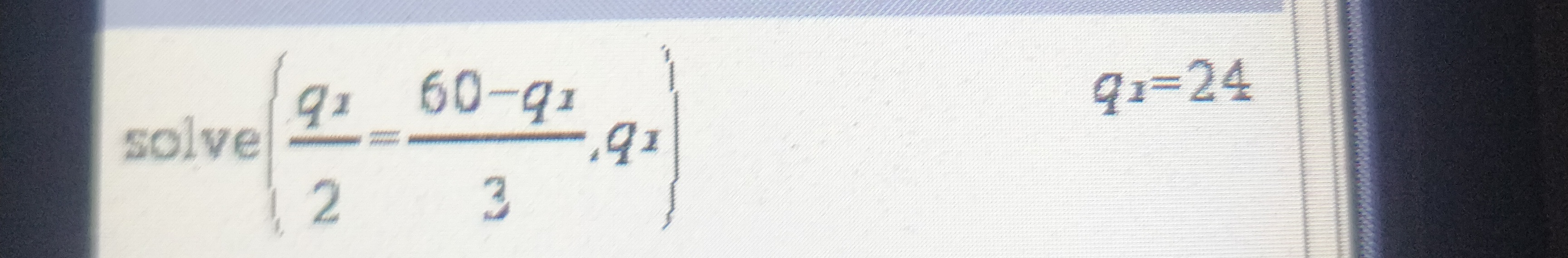

Is there any way to solve proportion's like in TI-nspire cx? (look at picture)

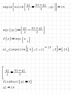

with Maple
or with Maxima

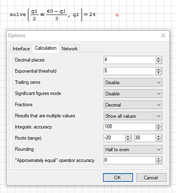

Hi. In addition to the churichurro solution you can also use SMath native solver after changing the roots range.

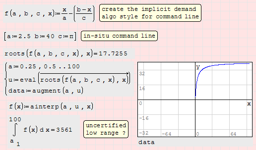

#7 Posted: 10/17/2022 7:50:38 AM
Solve Forum.sm (4.56 KiB) downloaded 1190 time(s).
#8 Posted: 10/17/2022 10:13:40 AM
598 likes in 1,379 posts.
In addition to Razonar's reply;
You can also determine solve() range within the function itself.
You can also use roots() and FindRoot().

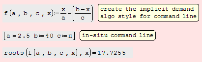

#10 Posted: 10/17/2022 9:28:37 PM
There are also plugin solvers.
Maxima can be added to collection as well.
plugin_solvers.sm (5.69 KiB) downloaded 1160 time(s).
