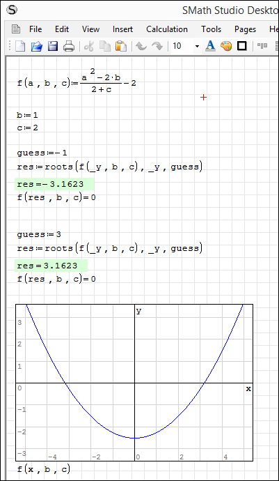

1. FindRoot function does not work.
2. Definite integral does not work.
Everything works as expected for me:
Please help to reproduce.

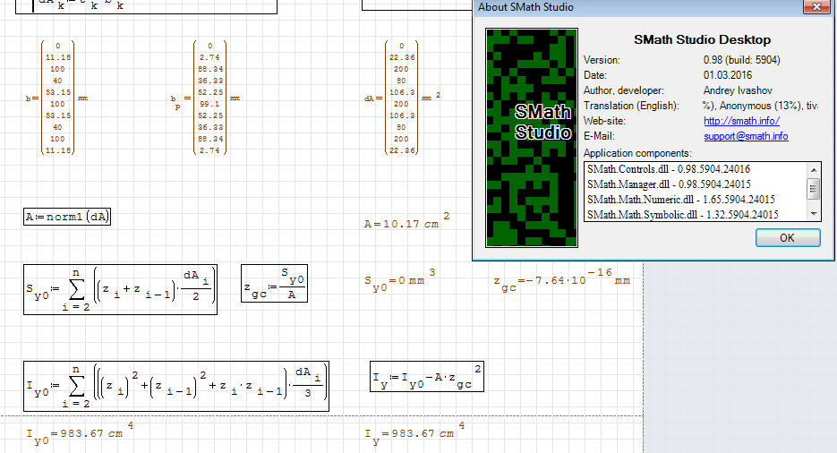

The following file worked well in Smath 97.5890 up to yesterday.
But under the latest version, the calculation for definite integral gives an error.
Can somebody help me in this regard please?
Reservoir Flood Capacity Estimation-R1.sm (190.72 KiB) downloaded 1494 time(s).

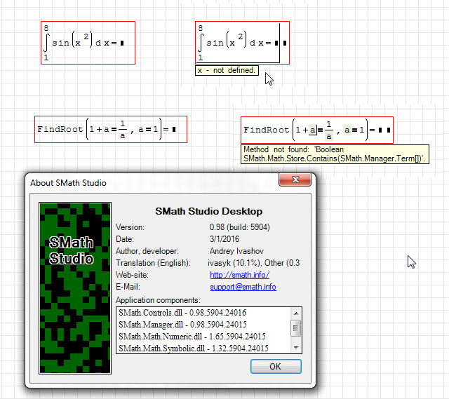

#12 Posted: 3/2/2016 9:11:41 AM
Hi Andrey!
Thanks very much for the new version.
I observe the following.
It will not work for me as well, although I have to admit that I installed bunch of plugins.
However, fresh install with only Davide's Nonlinear Solvers (FindRoot() function is from there) and Martin's Smath Handbook will give this
1. FindRoot() will give the same error as on the picture
2. Definite integral works
Davide Carpi 3/2/2016 9:39:00 AM

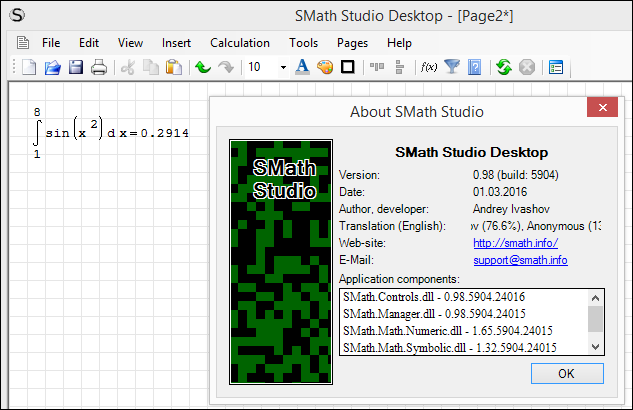

I have no problems with integrals, no exceptions in the files above (Reservoir Flood Capacity Estimation-R1 / TestSum).
Andrey Ivashov 3/2/2016 10:29:00 AM

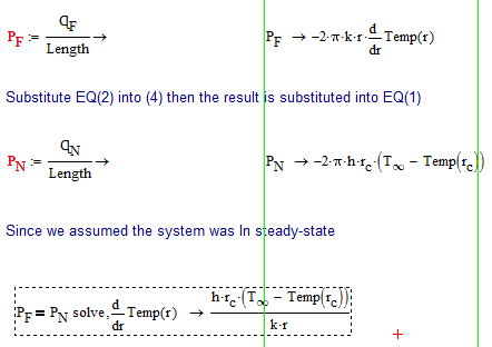

Any information on the symbolics? I am trying to recreate a "proof" from a Mathcad file and I'm missing some features (or cannot find). Are we allowed to post Mathcad files on this forum? If so, I will post all of the relevant files.

#19 Posted: 3/2/2016 11:29:36 AM
NDTM Amarasekera
NDTM Amarasekera
130 likes in 352 posts.
Hi Radovan,
I had a bunch of so many plugins.
So, uninstalled, including all plugins in %APPDATA%/Smath folder and did a clean install.
My problem was solved.
Thank you very much.

...Any information on the symbolics? I am trying to recreate a "proof" from a Mathcad file and I'm missing some features (or cannot find). Are we allowed to post Mathcad files on this forum? If so, I will post all of the relevant files.
Specifically, I thought that "symbolic solve of algebraic equations" was implemented in version .9X. Keywords in symbolics would be fantastic too!
