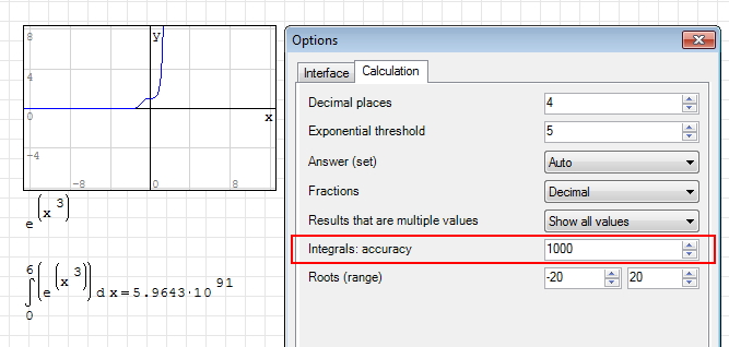

#2 Posted: 11/25/2015 7:18:55 PM
You have to increment the accuracy of the integration.
This option is available in: Tools > Options > Calculation
