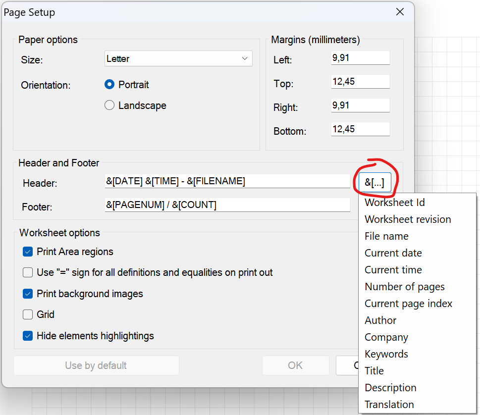

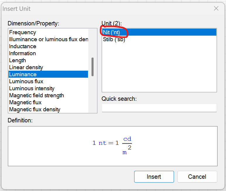

Can someone help me understand what these new improvements do:
Page Setup dialog improved to allow selecting available substitutions from the dropdown lists for header and footer;
The non-SI nit unit of measurement added to the Luminance dimension;

#2 Posted: 12/27/2024 6:58:27 PM
2,340 likes in 4,041 posts.
It is about these buttons:

#3 Posted: 12/27/2024 7:00:24 PM
New unit of measurement added:
