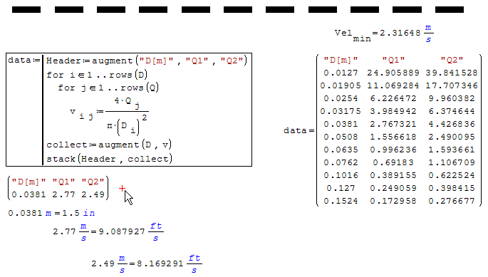

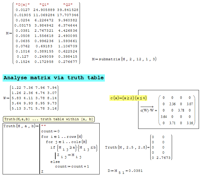

#5 Posted: 4/14/2016 9:12:40 PM
#6 Posted: 4/15/2016 12:08:14 AM

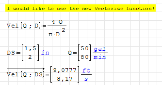

Just remove erroneous declarations, and use DS in function invocations (your D variable is defined having 11 rows, Q has 2 rows, you should use DS having 2 rows).
Vectorize and Program.sm (14.58 KiB) downloaded 1312 time(s).
P.S. My screenshot is just a follow-up of previous suggestions (Jean's and CBJ's).
My sheet is another approach without any loops, just vectorize() end eval().

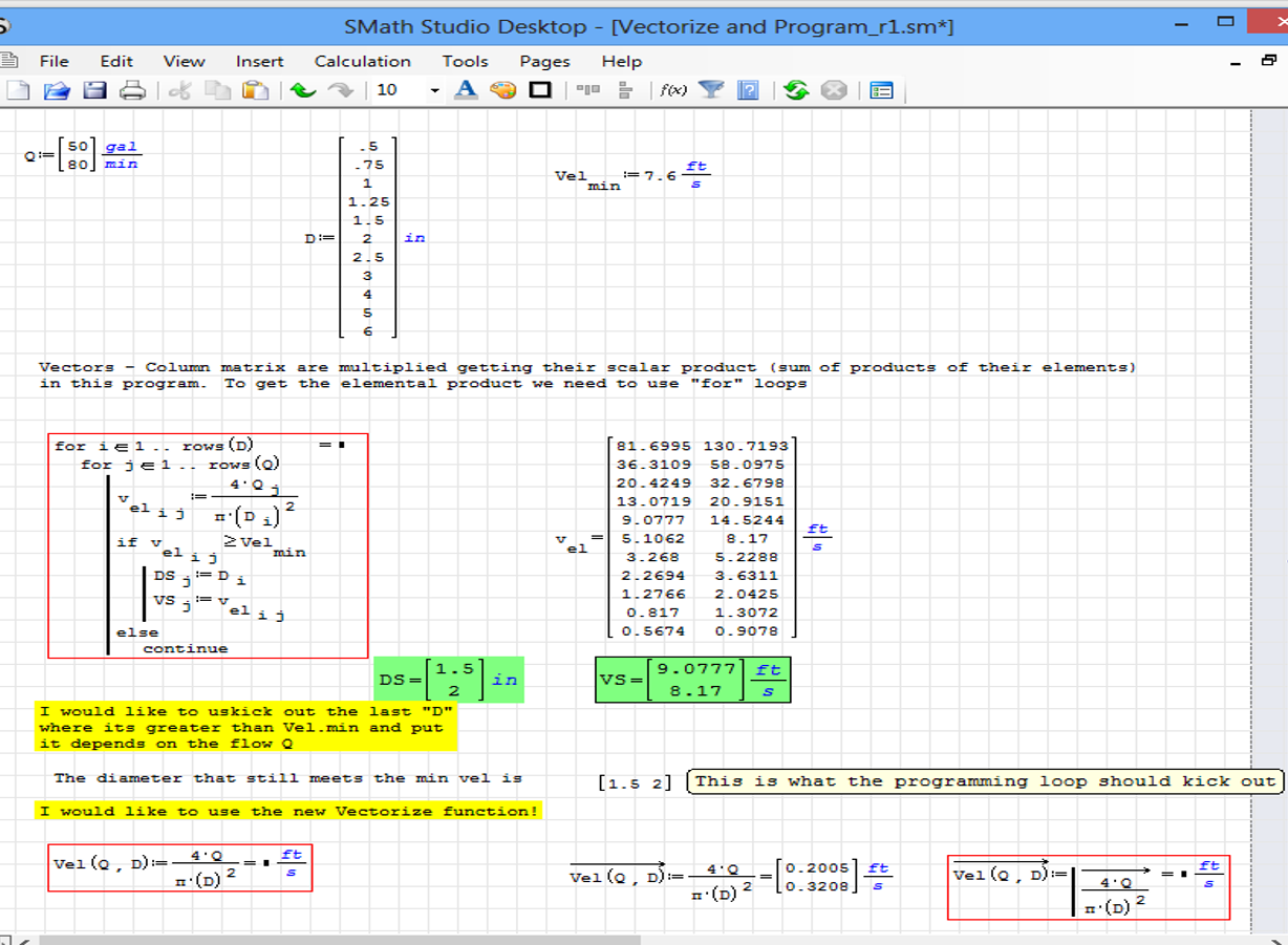

#10 Posted: 4/15/2016 11:17:43 AM
What's wrong with the counter? Getting "0" for first output, not 1.5.
Vectorize and Program a.sm (9.56 KiB) downloaded 1266 time(s).
#11 Posted: 4/15/2016 12:10:37 PM
You have an error, the "Line " command should be in the second loop.
Annex corrected fileVectorize and Program a_r1.sm (9.57 KiB) downloaded 1303 time(s).

#14 Posted: 4/18/2016 1:31:32 AM
Elsid,
Nowhere else than in my Mathcad web site [maybe killed by PTC] you will get the visosity of water
Here in Smath http://en.smath.info/forum/yaf_postst7460_Water-Viscisity--cp.aspx
