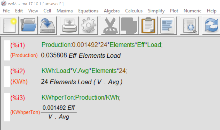

How can I achieve this in SMath (currently wxMaxima)

I wish to ...but this feature is disabled for me ..that's why the image

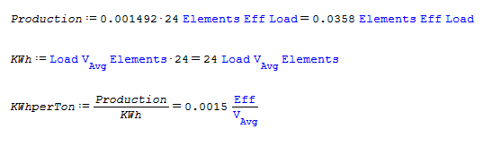

#4 Posted: 4/11/2018 7:18:51 PM
You might try something like this

Ah... Ok thank you. You have made them units
