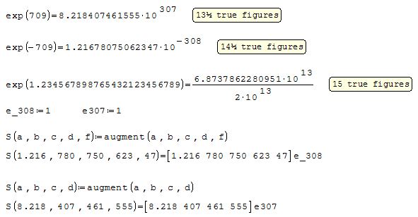

#5 Posted: 4/15/2020 5:17:46 PM
It's also a very good enhancement to help the "finishing" of documents.
Not so much use, whereas no CAS displays/accesses > 15 figures
Utilities Round(U,n).sm (13.18 KiB) downloaded 1069 time(s).
