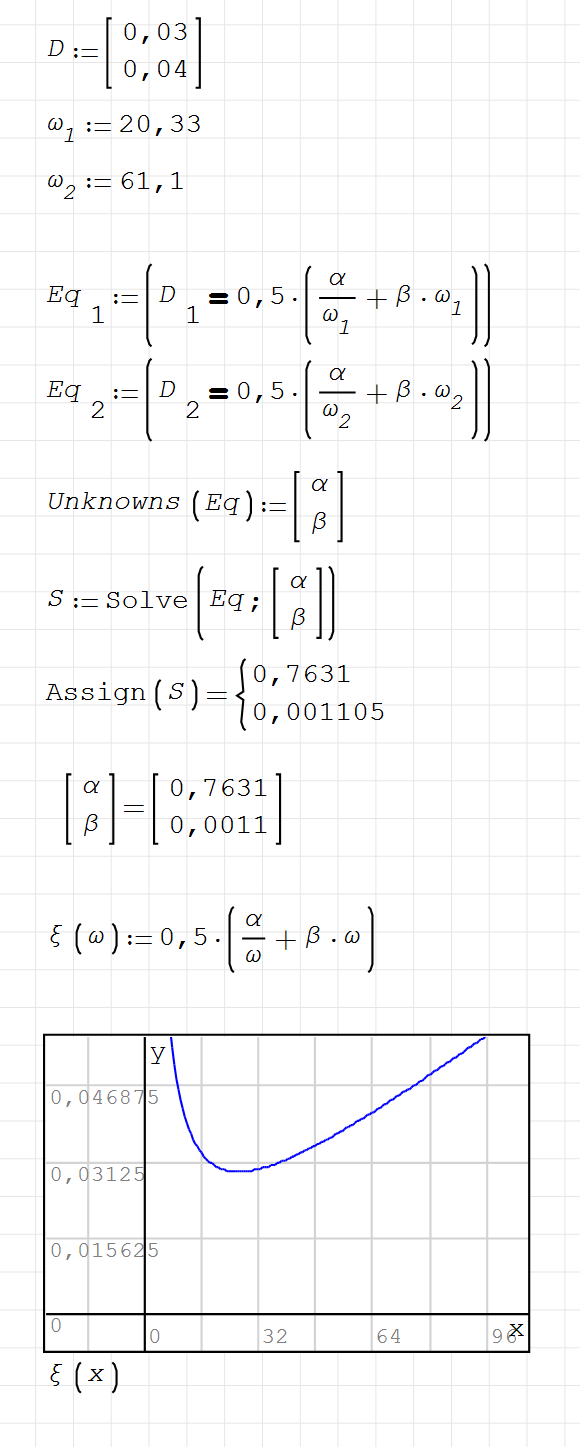

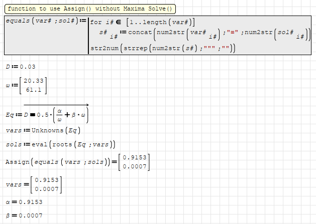

You can use roots() for your function. And a vectorize() can simplify it.
However, to use Assign() you will need this function to merge vars and solutions.
Assign_without_Maxima Solve().sm (7.36 KiB) downloaded 1239 time(s).

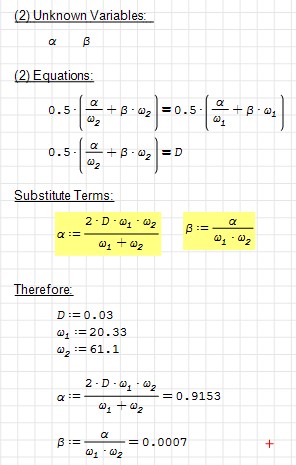

Greetings,
Another approach would be to use some elbow grease, you can substitute terms by hand and solve for 𝛼 and 𝛽:
Keypress (You can copy/paste the following into your worksheet):
α:{2*D*ω.1*ω.2}/{ω.1+ω.2}
β:α/{ω.1*ω.2}
*NOTE: ω.1 and ω.2 shown above are variables with subscript, they are not vectors ω[1 and ω[2; You should be able to substitute ω.1 for ω[1 if that serves your purposes.
- Kenny Lemens, P.E.

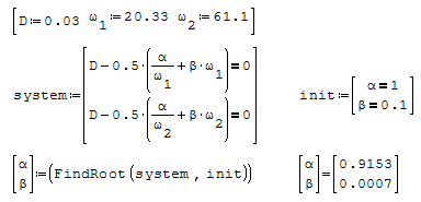

If the damping coefficients are denoted by α1 and α2, you can use the function al_nlegsoive
test.sm (6.99 KiB) downloaded 1261 time(s).

... more in there from native Smath code.
Solve FindRoot FORUM.sm (10.9 KiB) downloaded 1233 time(s).

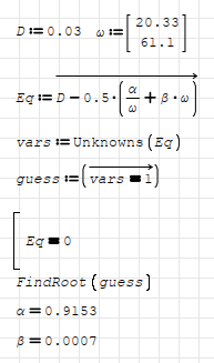

solving with uni's latest addition mathcad blocks;
you wouldn't need Eq: actually, but it can be shown.
mathblock.sm (5.15 KiB) downloaded 1234 time(s).

#10 Posted: 4/7/2022 6:19:34 PM
598 likes in 1,380 posts.
I think this is the most sophisticated method of my way.
It can get unknowns from equation, solve them.
In the end assigns numerical values to unknowns.
You don't need to define alpha or beta or any variable.
All process is automatic.
mathblock_v2.sm (5.19 KiB) downloaded 1246 time(s).

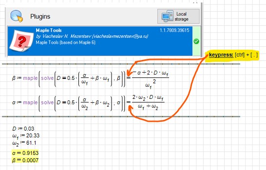

⚜ Kenny Lemens, P.E. ᵂᴵ
85 likes in 180 posts.
Greetings,
If plugins are considered, you can also consider the use of Maple:
In the image I posted, the 'equal sign' shown on those two equations are actually symbolic equals; keypress: [ctrl] + [.] instead of keypress [=].
Kenny Lemens, P.E.

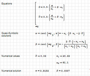

Hi. The isol solution, using only the Mathcad block plugin.
isol_example.sm (68.13 KiB) downloaded 1187 time(s).
isol_example.pdf (34.57 KiB) downloaded 660 time(s).
