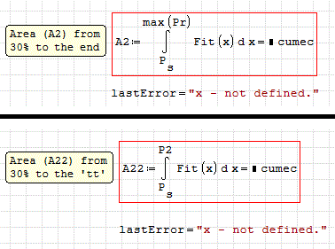

#2 Posted: 4/8/2016 8:17:49 AM
598 likes in 1,380 posts.
integrals aren't calculated in this example. Culprit is maxima plugin.
