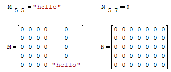

#2 Posted: 2/3/2017 4:01:09 PM
ZeroMatrix: like this
But it is not. If I insert M(0) is length matrix 1, but I need length matrix 0

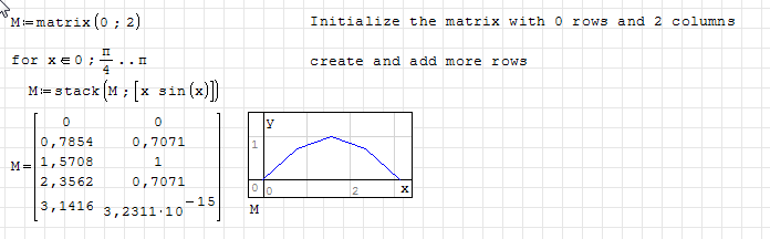

#8 Posted: 2/3/2017 9:29:55 PM
1,355 likes in 2,270 posts.
Example for declaration and use of an empty matrix:
stack.sm (11.99 KiB) downloaded 1345 time(s).
Arie 2/3/2017 10:03:00 PM
#9 Posted: 2/3/2017 10:03:19 PM
Arie
Arie
94 likes in 285 posts.
Awesome. Thanks, Martin. I did not know that empty matrices were supported.
