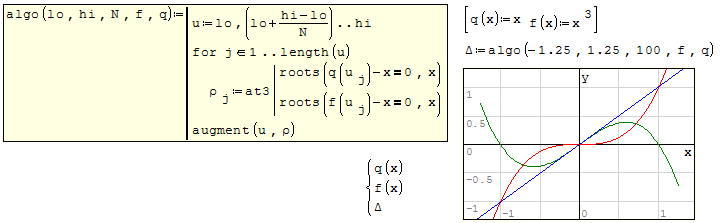

#3 Posted: 10/16/2021 10:55:33 AM
... here is a typical seeded roots scanner.
You can spline for in-situ calculation.
Solve Inverse [Seeded Scanner_roots].sm (16.52 KiB) downloaded 997 time(s).

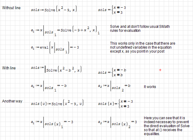

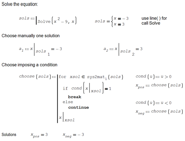

Hi. You can try this approach.
filter maxima solve solution - choose.sm (8.72 KiB) downloaded 1200 time(s).
Thanks! Very interesting use of the at() function, I didn't know it could be used with Boolean also. I not fully understand what the line() does to Solve(), but I tried without and and seen for myself that it will not work without.

... I not fully understand what the line() does to Solve(), but I tried without and and seen for myself that it will not work without.
Hi. line( ) does the same as defining sols (u) = Solve (eq, u)
filter maxima solve solution - line.sm (11.49 KiB) downloaded 1206 time(s).
