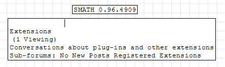

This happens when the clipboard contains strings with spaces (Win7 x64 / SMath Studio 0.97)
P.S. this not happens using the nightly build 0.96.4909

update: I notice the same issue even when I copy and paste a string with spaces from a text area to the canvas (so probably the HTML data is not the cause)
