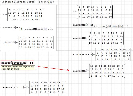

Why this happens with attached worksheet?
Mirror_Problem.sm (20.51 KiB) downloaded 716 time(s).
Davide Carpi 4/11/2017 6:22:00 AM
#5 Posted: 4/10/2017 6:43:24 PM
The two red regions created "Unknown error".
The algorithmic chain fails.
Mirror_Problem.sm (20.51 KiB) downloaded 704 time(s).

#6 Posted: 4/11/2017 6:22:38 AM
1,434 likes in 2,912 posts.
You found a bug in el(), thank you!
added in BTS [SS-2438]
#7 Posted: 4/12/2017 8:20:09 PM
Hello Davide,
IMHO, the case reported by collab NDTMA is not a bug.
Simply an instance of "shadow in the context" [Mathematica].
Similar broken algorithmic links have been encountered in Mathcad.
We can't play much with the "vector/matrix" codes.
Here is a similar example in the attached.
Cheers, Jean
