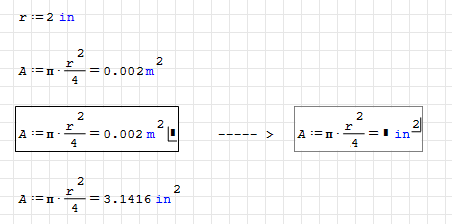

... or like this in silent unit:
1. x*in ... in from unit panel
2. backspace twice to remove in
3. at this point you see a big round place holder,
4. in that special place holder ... in from unit panel
5. 'in in blue is now silent for result 'in²

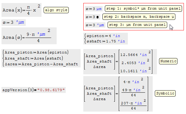

... make it hi-pro algo style.

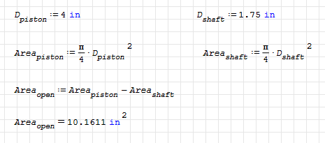

One follow-up, if I set the equation to optimization none to show the numeric values they all default to meters, is there a way to have them shown as inches?

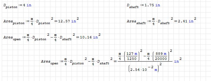

#12 Posted: 7/16/2020 1:33:43 PM
Construct as is, it may have to do with your SS version.
Otherwise, you are wrongdoing, not following guidance.
#13 Posted: 7/17/2020 4:29:22 AM
1,355 likes in 2,270 posts.
Once again, I want to thank everyone for their help.
I am going down the path of using the units. Took me a couple of attempts to get the in2 but it is now working
Definitions are converted to SI upon storage (you see that when you hover with the mouse over a definition. Control of display units is just by the optional placeholder, where you can insert any factor (a unit or pi or any variable name which your result may contain)
Also note that the default display unit depends on optimization. Numeric and symbolic display different units, e.g. 1/s defaults to Hz in numeric optimization and to 1/s in symbolic.
