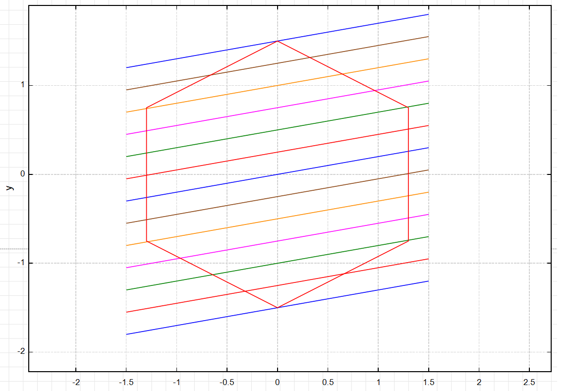

Hi everyone ,I'm doing a momentum curvature usign Popovic's Method and found a big problem beacuse to divide a polygon(convex and concave) into small fiber like this image but with more lines:
General Polygon
it's not so easy to do an algorithm. I did a smath file when the polygon it's rectangular but for more general case my smath code doesn't work, I'd like know an algorithm, code or function if it's posible in smath or other language to develop.
Jesus.
Verificacion_de_fluencia_en_acero_fiber_method_degradation_forum.pdf (550.67 KiB) downloaded 1101 time(s).

If I understand ...

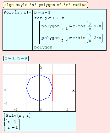

Your polygon has 9 vertices, we can try a circular spline.
That will add as many points between vertices, is it ?
From there: Area, Perimeter, Center of Gravity.
Give the vertices... Jean.

Hi Jean, exactly I need to known the area, center of gravity and perimeter of the division but the polygon doesn't need to have 9 vertices, this is an example in this case. In general ,I'd like to calculate for n vertices polygon(convex or concave),let me give an example in smath for regular polygon.
polygon_2.sm (36.33 KiB) downloaded 1301 time(s).
Jesus.

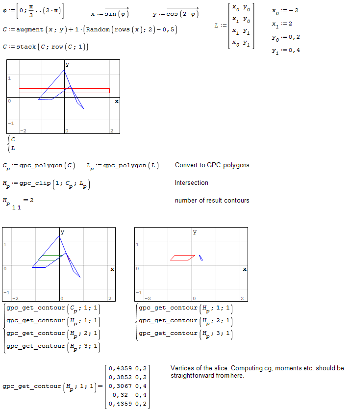

This might be an application for the GPC wrapper plugin by Davide.
gpc1.sm (12.5 KiB) downloaded 1299 time(s).

Hi Jean it's an excellent solution, thank you so much , I did a code with GPC plugin and I could get this results.
polygon_irregular_fiber_borrador1.sm (34.31 KiB) downloaded 1331 time(s).
polygon_regular_fiber_borrador1.sm (35.48 KiB) downloaded 1313 time(s).
Jesus

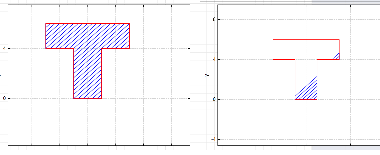

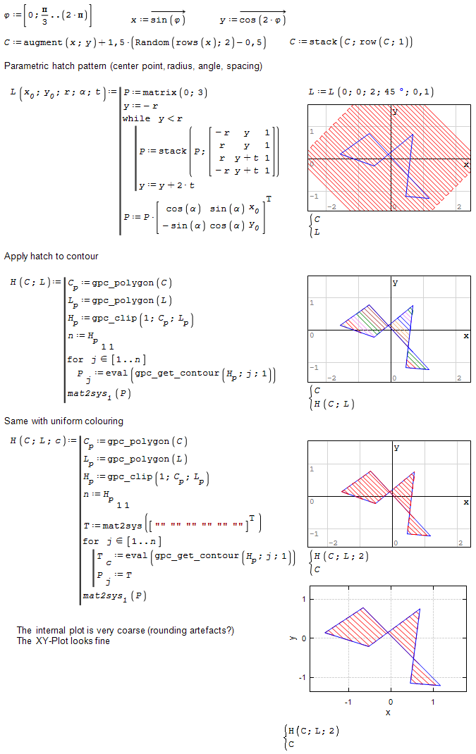

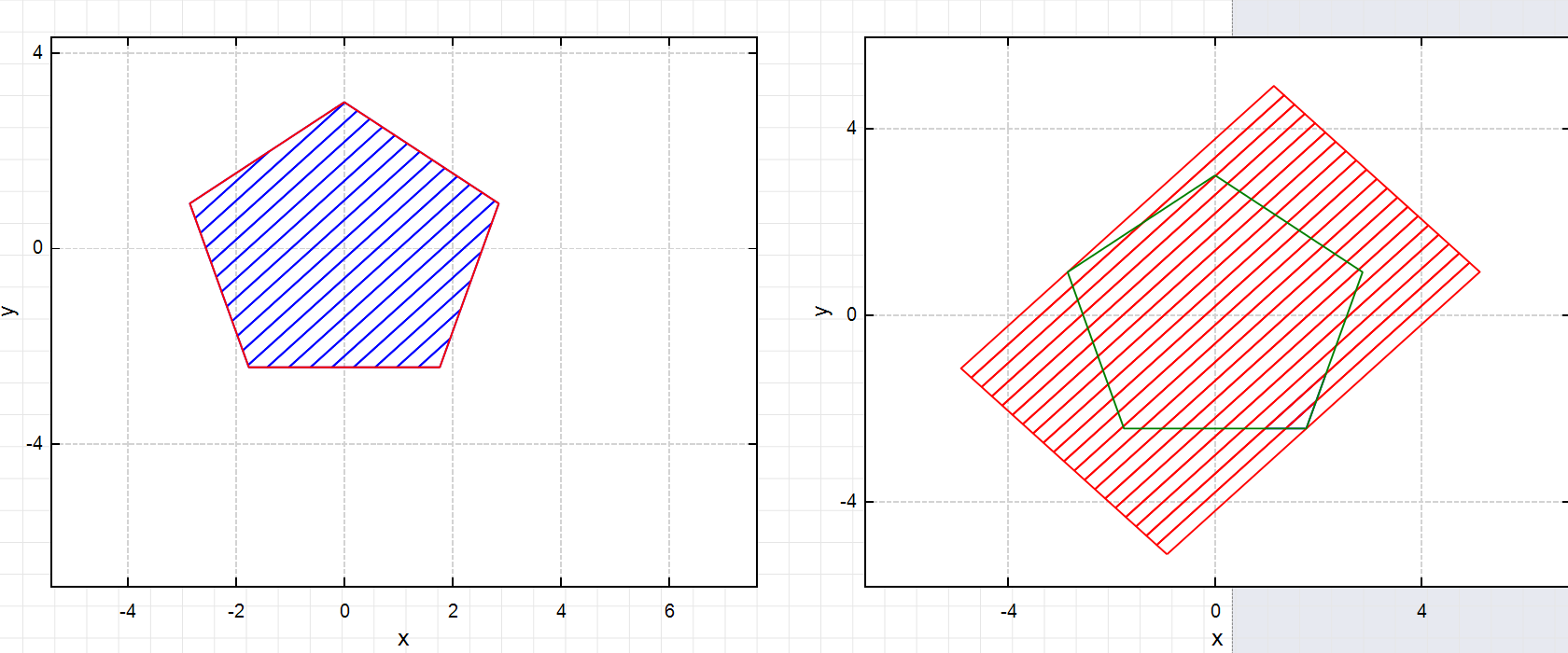

#11 Posted: 8/1/2022 7:06:15 PM
General hatching procedure for arbitrary contours
gpc2.sm (42.6 KiB) downloaded 1347 time(s).

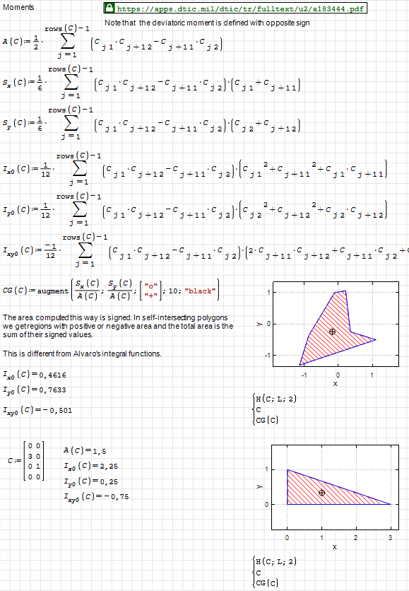

Will we be able to calculate the static moment and the moment of inertia of any section with these tools?
#14 Posted: 8/2/2022 6:41:33 AM
gpc3.sm (135.5 KiB) downloaded 1388 time(s).
sergio 8/2/2022 11:10:00 AM
#15 Posted: 8/2/2022 9:21:54 AM
I guess we can not use the same matrix of contour point to get the area and de center of mass ... Or am I wrong ?
