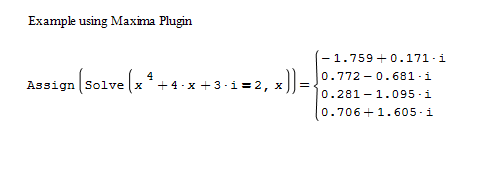

Here an example solved by using Maxima plugin:
best,
Oscar
best,
Oscar

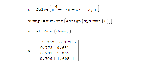

How to put these answers of Maxima plugin inside a vector?

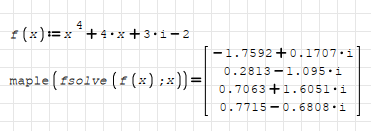

You can use maple() too.
Maple has a fsolve() function.
Which uses floating-point arithmetic.
3 users liked this post
ioan92 11/18/2023 11:28:00 PM, Oichi 11/18/2023 9:23:00 PM, Oscar Campo 11/18/2023 8:21:00 PM
A little trikiest

Okayy,,,The trick using num2str is so cool..
And thanks overlord, I didnt know about this maple one

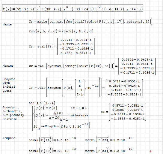

Hi. Another way.
zroots.sm (19.36 KiB) downloaded 1385 time(s).
Oscar Campo 11/19/2023 3:45:00 AM, ioan92 11/19/2023 3:49:00 AM
