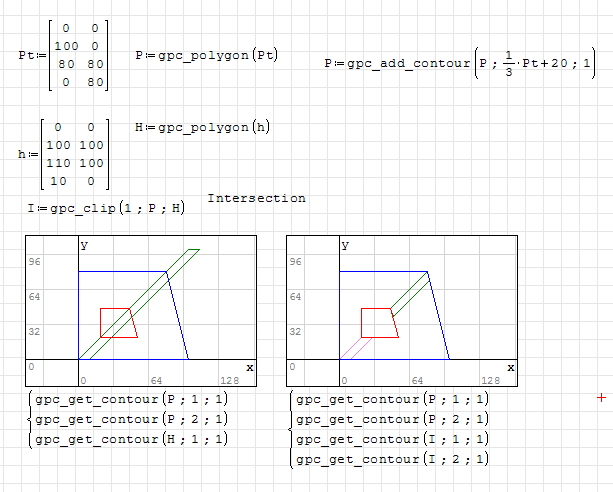

I'm looking for suggestions to find the intersection of two polygons and hatch the result.
The most particular case concerns the hatching of a part of polygon intersected by a straight line.

Perhaps the GPC (general polygon clipping library) wrapper plugin might help. The basics are described in section G.3 of the german handbook.
You also might have a look at the hatch and fill snippet.
