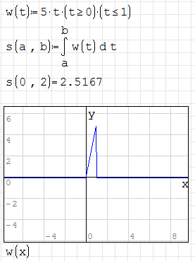

Hello, I have very annoying problem, i don't know how define this integral from mathcad in smath:
Integral Problem
I read some tutorials from wiki, and i still don't know how write it in smath
Could anybody help?
Thanks
Piotr
#2 Posted: 7/10/2013 7:04:41 AM
1417 likes in 2873 posts.
Try this
regards,
Davide

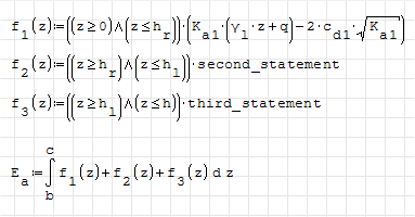

#3 Posted: 7/10/2013 7:18:00 AM
kilele
kilele
133 likes in 397 posts.
see also the piecewise integral topic on mkraska's handbook
