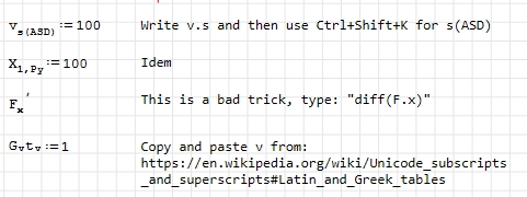

Below is an example of a variable used in wood shear wall calcs where 2 values for shear modulus (Gv) and thickness (tv) have been combined into 1 tabulated value of Gvtv with the "v" in subscript. SMath doesn't allow getting in and out of subscript entry in one variable definition, as far as I know.
The vs.asd entry below that is one that neither SMath or Mathcad will accept as NDS shows it, since NDS uses "s(ASD)" in the subscript, and neither program recognizes parentheses as part of a variable name, even in a subscript. So for that one, I may just have to use a period or underscore or some other alternate notation from what the published standard uses. Another case that I see used a lot in published engineering calcs is the use of a comma in a subscript, such as "P1,y" where the 1,y" would be in subscript. I don't think either Mathcad or SMath allow that, but it is a common notation from what I've seen.

The Fc⟂ entry is one I figured out I can insert from Windows Character Map, although it comes out somewhat tilted in SMath, like it's italicized.
Finally, the last picture is from Mathcad of how NDS represents the adjusted design value for allowable compressive stress perpendicular to the grain. They put the apostrophe after the subscript. But similar to the Gvtv variable, I can't leave subscript entry to put the apostrophe at the normal text level in SMath. I can put it in at that level before the subscript, but then it doesn't quite look the same. Has anyone else used SMath for published works where you wanted to match a particular formatting like this? Is there a workaround?

Hi Jason. Some notes.
SomeFormats.sm (3.89 KiB) downloaded 1179 time(s).
Jason McCool 8/1/2021 7:16:00 PM, Erick Valentino 10/1/2021 7:27:00 PM

Hi churichuro.
It comes from mathcad, I don't know from which version or even which one is valid. It is used to use characters that are usually operators in the definition of variable names. That is, to write things like "a/b" or "a+b" as variable names, or variables with spaces "a b", and some others cases.
I suppose that somewhere here it must be documented, but I don't know where. For instance, not here: https://smath.com/wiki/Keyboard%20shortcuts.ashx . The line describing it could be:
Ctrl+Shift+K - For type characters that usually insert operators.

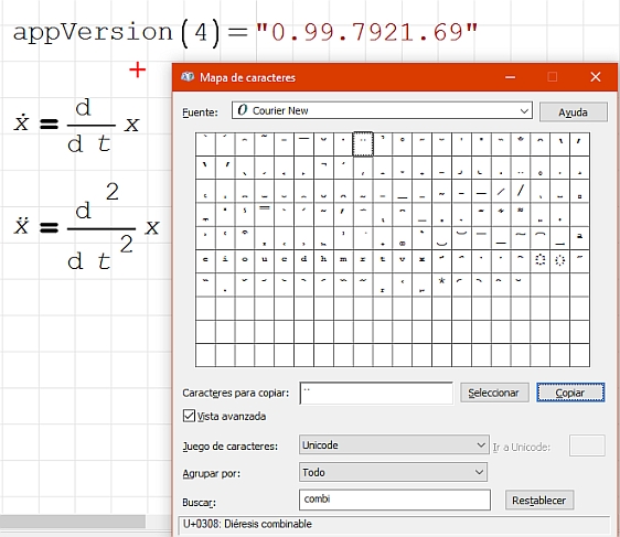

Adding on to this topic, I just came across something surprising that I can't get either Mathcad Prime or SMath to do: write a single dot or a "hat" (or caret, or circumflex accent) above a variable. This is really surprising given how common these symbols are in math from high school and college up to various engineering disciplines, and both programs exist to allow us to solve math in its symbolic "native language" as opposed to a bunch of obfuscated cell references in a spreadsheet. I've tried using the diacritical combining marks from Windows Character Map in both programs, and some of them work and some don't. I've looked through different fonts, and some, like Courier New, have more combined letters like u with a double dot or j with a caret, but I would really like to be able to match up my variables with the textbook examples for ease of debugging and for standardization for peer review. On a side note, Mathcad 15 would allow several of these characters. Any chance that this is possible in SMath with some workaround I'm not aware of, or that it could be someday? It seems like PTC really took a step backwards in going from Mathcad to Mathcad Prime in that there's a lot of things Prime can't do that Mathcad had always been able to do. This might be an area where SMath could be better than Mathcad Prime, for what it's worth.

Hi Jason. You're absolutely right. Without a right notation, it's very difficult to solve and share the result. It is also quite frustrating to spend time and intellectual resources in the management of the units when what one wants is to ensure a reliable result that allows its review and traceability.
Try to search "comb" or "combi" in charmap, copy and paste in SMath. If doesn't work, try to open the attached SMath file, if your system doesn't fully support unicode maybe you can't see this, like what happen in my virtual windows 7.
OverDot.sm (2.65 KiB) downloaded 1218 time(s).
Addendum: Apparently no character that has "accent" in its name can be combined with consonants. This is à ä â but x` x¨ x ^.

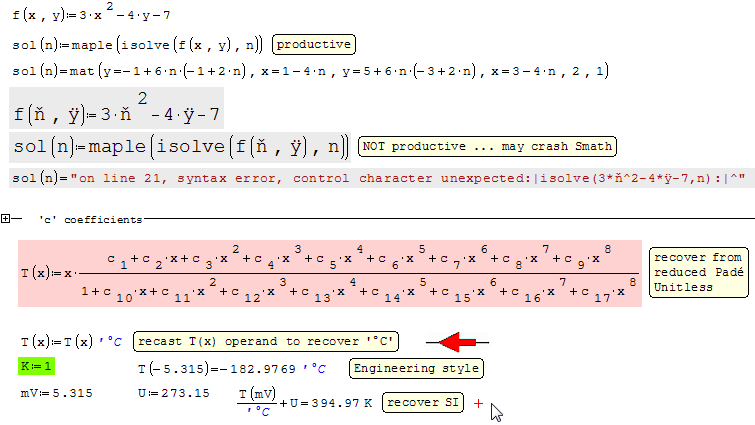

#17 Posted: 10/3/2021 11:44:09 AM
598 likes in 1,380 posts.
You are writing temperatures wrong.
That was discussed before in the forum.
And you are completely wrong about units.
No one will follow your unitless crusade, even you don't.
You just create your own unnecessary "silent units".
Math is unitless, science/engineering is not.
Oscar Campo 10/3/2021 3:41:00 PM, Jason McCool 10/3/2021 12:02:00 PM

LaTeX is at least an option, it makes compound symbols out of basic characters and decoration symbols. Having an x-umlaut character is just a poor replacement for \ddot x. So I rather accept that SMath can't handle well decorations instead of font-mining for look-alikes.
#20 Posted: 10/3/2021 2:20:17 PM
LaTeX is at least an option, ...
Hi. True, but then the point is how to write those expressions in latex within SMath.
Wolfram's Mathematica solution, where everything are expressions, is to use functions, like OverDot, OverVector, OverHat, etc. Here is a listing.
It can be quite practical, since you can define notations such as OverHat[x]:=x/Norme[x] or OverDot[x]:=Diff[x,t].
The EES solution is smaller, but much more practical. From the help of the program:
"A dot, bar, hat, or tilde can be positioned over the variable name by adding _dot, _bar, _hat, or _tilde to the name. ... X_ddot will display with a double-dot centered above the X. X_infinity will display as X subscripted with the infinity symbol. X_prime will display as X 'and X_dprime will display as X''"
I suppose that the latter is a solution that can be implemented in SMath without many problems.
