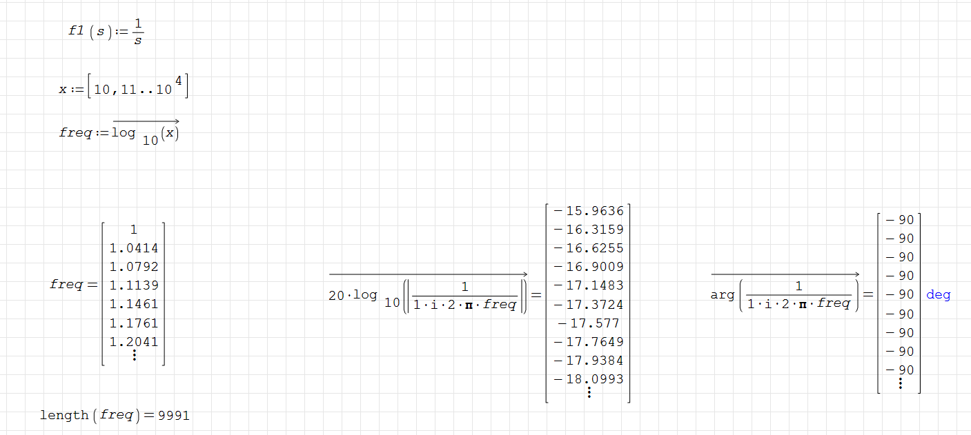

But how can I plot these 2?

Cornel,
The arguments for a plot must be a function or a couple of column vectors.
I your case you can use in your plot the vectors you are calculated and use as input for the graph:

But I want to plot augment(freq, 20*log()) and augment(freq, arg()), which does not work..this îs the problem
#6 Posted: 12/23/2024 3:30:00 AM
135 likes in 309 posts.
augment(freq, arg()) and augment(freq, 20*log()) really works... only must adjust the axis... your yaxis is set 0~100 and your data appear in the 0~(-100) axis
