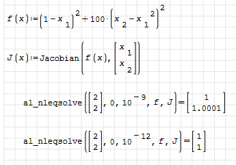

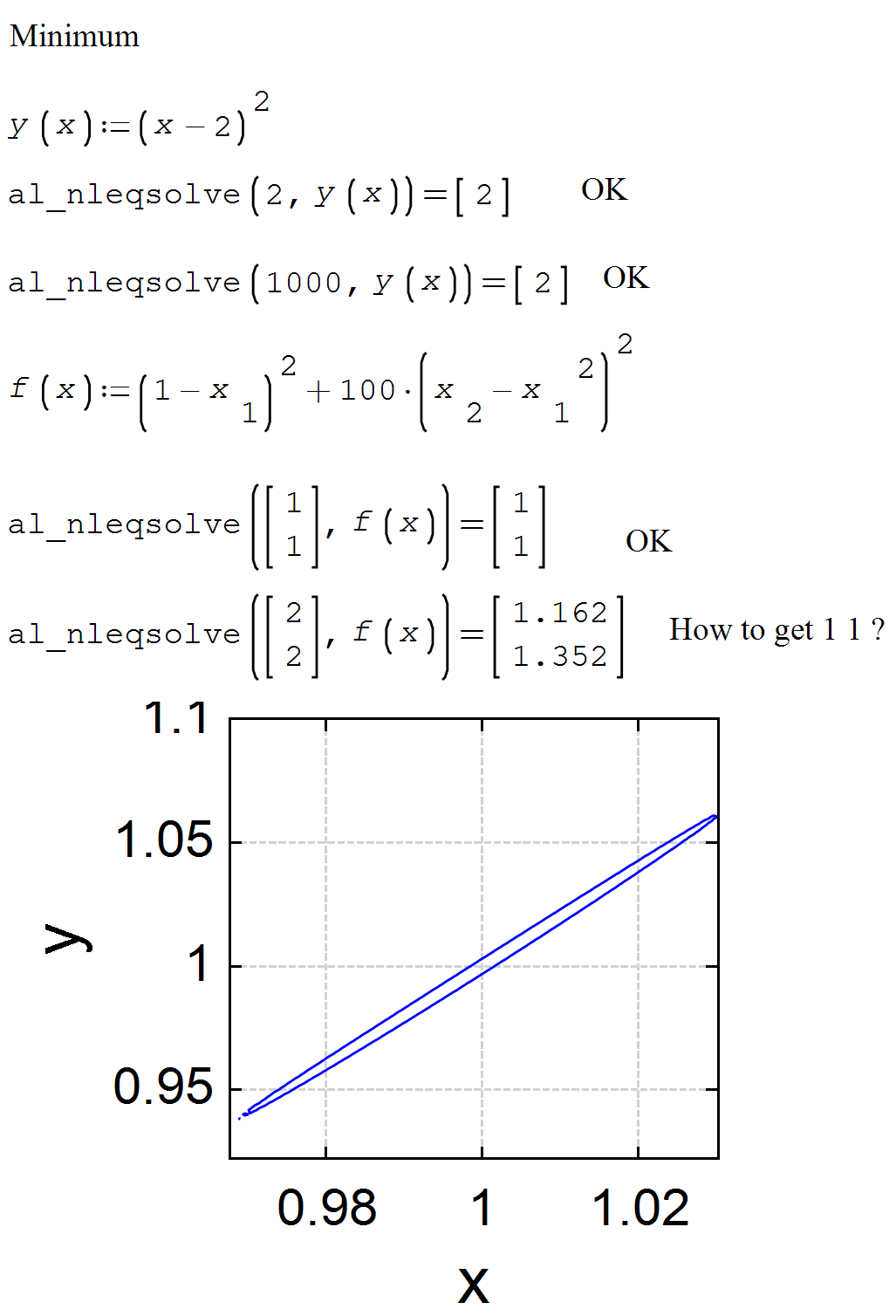

SMath Forum SMath Studio Questions al_nleqsolve 1 Pages (2 items) al_nleqsolve - Messages Go to last post #1 Posted: 9/24/2024 1:27:58 PM Valery Ochkov 66 likes in 697 posts. Group: User How to get a correct answer?al_nleqsolve.sm (9.71 KiB) downloaded 1497 time(s). #2 Posted: 9/24/2024 7:26:40 PM Alvaro 1,125 likes in 1,798 posts. Group: User Hi Valery. You can power the solver specifying the Jacobian.al_nleqsolve.sm (12.62 KiB) downloaded 1512 time(s).Best regards.Alvaro. 3 users liked this postValery Ochkov 9/24/2024 8:28:00 PM, sergio 9/24/2024 11:33:00 PM, ioan92 9/25/2024 4:57:00 PM 1 Pages (2 items) New Posts No New Posts
