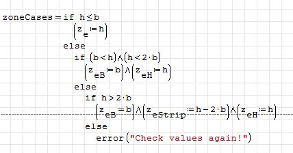

any way i can print a message in a for loop?
i have 3 cases that change 2 variables, but it would be useful to know in which case i'm in
thanks in advance
#6 Posted: 3/14/2013 10:08:17 AM
1417 likes in 2873 posts.
Something like this?
regards,
w3b5urf3r
zoneCases.sm (8 KiB) downloaded 156 time(s).

0 likes in 4 posts.
yes that did it,
thank you
