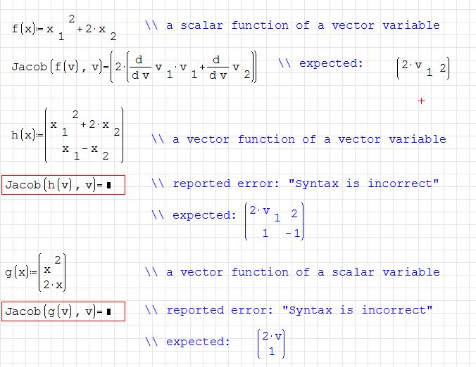

SMath Forum SMath Studio Bugs & Problems Jacobian not working properly? 1 Pages (3 items) Jacobian not working properly? - mb10 - Messages Go to last post #1 Posted: 8/28/2013 5:26:30 AM mb10 9 likes in 20 posts. Group: User May be I'm not using the Jacobian function in the appropriate way, but it seems to me it does not behave as expected.See below.EDIT: SMath version: 0.96 - build 4909 Jacobian.sm (9.22 KiB) downloaded 1263 time(s). #2 Posted: 8/28/2013 8:18:33 AM Martin Kraska 1,359 likes in 2,273 posts. Group: Moderator You may consider using the function Jacobian from the Nonlinear Solvers plugin by Davide Carpi. Jacobian_testing.sm (9.8 KiB) downloaded 1286 time(s). Technische Mechanik mit SMath Studio: https://link.springer.com/book/10.1007/978-3-658-50592-9 #3 Posted: 8/28/2013 9:05:34 AM mb10 9 likes in 20 posts. Group: User Thanks. 1 Pages (3 items) New Posts No New Posts
