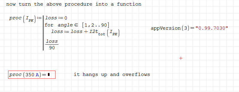

Firstly thank you for such a wonderful free alternative to MathCad 15.
Please see attached .sm file.
The comments describe the bug ...
Thanks in advance
test bug.sm (16.34 KiB) downloaded 1440 time(s).

Hmm,
I just re-tested on my home PC, freshly booted, same problem.
appVersion(3) = "0.99.7030" not .7219 <- Could this be the difference?

Hmm,
I can confirm this hangs on 7030. I was running 7219 before and did not have an issue. My guess is this should be fixed in next stable release and already seems to be fixed in Beta releases. The question is whether or not the "fix" is intentional or not.

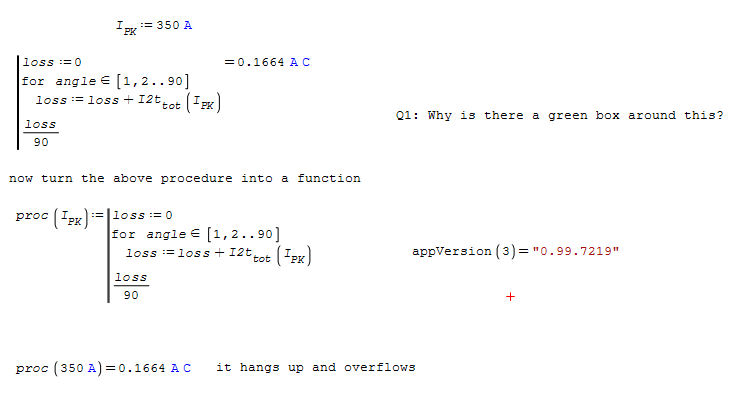

#8 Posted: 10/15/2019 5:43:18 PM
I will install 7219.
IMHO, not the best option yet.
Who can guess what the angle for loop should be doing ?
There are no maths associated with !

#9 Posted: 10/15/2019 6:05:01 PM
test bug Red.sm (20.37 KiB) downloaded 1351 time(s).

angle was originally used as such, but I modified it as a troubleshooting step, with no change to the bug's behavior
loss := loss + I2ttot(sin(angle*deg)*Ipk)

Hopefully my Maxima plugin continues to work.
It works properly on .7219.
But Maxima doesn't work.
