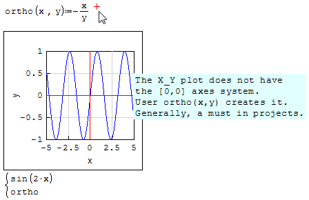

In the collected plot, neither f, XY, xy can issue this error message.
Hope not, otherwise X_Y would be all bug.
The module ortho(x,y):= -x/y may be the guilty. Try to remove it.

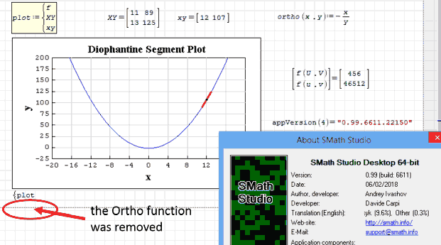

Hello Jean,
your file runs perfectly in the version of Smath Studio "0.98.6484.11448",
and fails in the versions "0.98.6179.21440" and "0.99.6611.22150", the error
is caused by the function "Ortho = -x / y". If this function is removed from
the graph, the error is eliminated, but only Parabola is plotted.

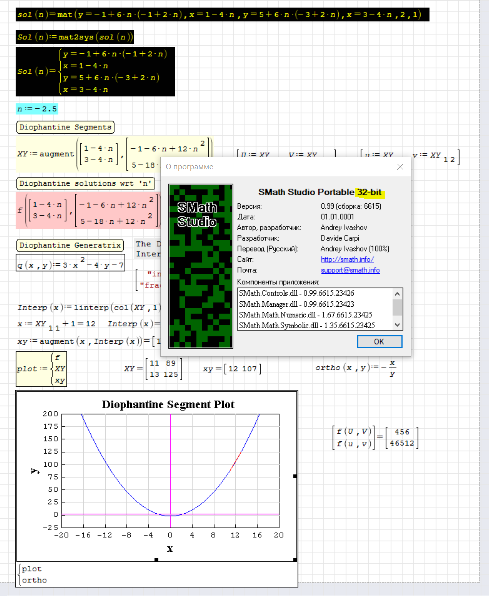

I have checked your worksheet and see question we have here is not about stable/not stable, this is about environment. I have checked different versions of SMath Studio (including 0.98.6484.11448, 0.98.6179.21440, 0.99.6611.22150) - error is shown everywhere.
Then I've tried to open SMath Studio in 32-bit mode and this helped! When it is 32-bit worksheet calculated without errors and graph is shown correctly.
So this is about 32/64 bit and present in all versions of the program.
(build 6615 32 bit = build 6611 64 bit)

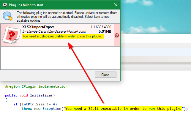

The bitness issue is typical of p/invoked libraries or external processes, something that smath can't manage automatically (except maybe introducing in the interface a flag that the plugin author can set manually to explicitly declare the plugin incompatible); however the developer can already throw an exception during the initialization to prompt the incompatibility to the user (mathcad efi f.e. has this check but it is suppressed in favor of his internal logger)
