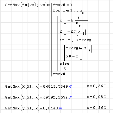

#24 Posted: 9/20/2014 4:31:41 AM
Is it possible to add a graph of the moment, shear, deflection in my post #27 ?
Yes. The functions defined in your sheet can directly be plotted using the built-in 2D plot region. It is sensible to define appropriate reference values for scaling, possibly the maximum absolute values. You probably need them anyways, so you might replace them in the denominators in the list of plot items.
BTW, do you trust the slope function (being all negative instead of changing sign at maximum y)?
beamplot.sm (80.65 KiB) downloaded 1300 time(s).

Could you maybe try and explain how/why/what you did when setting up the plot? I don't quite understand. I see that I'm really looking at a fraction of the total shear/moment/deflection, I'm curios to know why you set it up like that? I suppose this is OK but again in practice you really don't need the diagrams, so maybe I am wasting time however... Is it possible to show the actual shear, moment and deflection?
In the function I posted do you see a good way or procedure to determine the location of maximum moment and deflection?
Thanks again!!
#26 Posted: 9/20/2014 8:01:48 PM
Even if you do not really need the diagrams, they just provide a visual feedback on how the function understood your input data.
The plot uses the following techniques:
- plotting multiple items using a list (system)
- x is scaled by L in order to give it the required dimension. x in the plot region has no dimension on it's own. Thus no matter how long the beam is, the plot will occupy the interval 0...1
- in order to cut off the plot outside 0...1 I used the function ltlt() from Davide's function's extensions plugin, which displays as a ternary relational operator. See the help snippet.
- In order to plot curves of different units and different order of magnitude in a single diagram (and again in order to avoid axis scaling) I divided the curves by some arbitrary representative value (taking the absolute value). Here the max absolute values would have to go.
- the y curve has a - sign because I like to see the sag going downwards.
as for the min/max finding: The only really robust way ist brute force, see attachment.

Martin -> Thank you for the GetMax formula and all the other information. Quick question why do I have to is the formula defined with a function and the variable x? Meaning, we input the variable x as part of the getmax function but yet we just redefine x in the function as x#=xi. So therefore why even input x into the function in the first place?... I was about to post this question but I think I see the answer...Is it so that the function returns the Maximum value as well as the corresponding location "x"? I also don't understand how x is then defined I mean I see x# is defined but then somehow the variable x is defined. Does the letter "x" do something special or am I missing something here? I have updated my function as well.
ioan92 9/21/2014 2:39:00 PM
#28 Posted: 9/21/2014 6:01:08 PM
All function defined using a statement block (line function) handle their argument calls by reference and not by value. Therefore, you can use the argument slots for input and output, as was done with the second argument. The actual argument in the call can be any variable name, defined or undefined. It is re-defined inside the function and indeed I did that in order to return the max value and the location.
Consider the function parameters being I/O channels from the calling context to the function. You even cound make use of the contents of x inside the function and then overwrite it with some output information.
Alternatively, you can return compound objects like matrices and lists, as you do in your beam function.
The first argument of the function GetMax() is the function to evaluate. In the call this argument is the function name with the appropriate number of arguments. These arguments are irrelevant but must be undefined.

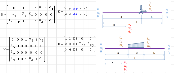

#29 Posted: 9/25/2014 12:30:46 PM
Ioan, the longitudinal displacements require an extension of the procedure and shall be implemented as soon as there is more time, along with Timoshenko beam theory (shear strain) and possibly, arbitrary beam directions (would allow for frames). I didn't try the distributed moment load yet.
Anyways, whenever a concentrated load or a change in distributed load function is present, a node is required, thus your first case is represented by 2 elements and the second by three. In order to get some convenience, one could write sort of pre-processor, which set's up the beam elements and nodes according to the required load pattern.
The attached examples just show the required matrices, I'd not recommend to derive symbolic solutions.
You find the matrices under http://smath.info/cloud/worksheet/wwekLPpH
ioan92 9/25/2014 1:12:00 PM
#30 Posted: 9/25/2014 1:25:42 PM
I imagine that it would be possible an integration on intervals for the basic cases that I draw.
This is in respect with the intention to avoid an annoying situation when nodes are needed not only for section and end conditions change but also in dependence on loads position.
Yes, this is possible, but I'd prefer the basic element being as generic as possible. Perhaps I just can't see the problem with added nodes because I don't know the actual usage context. In FEA codes it is even common to have node divisions without any external reason, just because the internal interpolation functions are not available for postprocessing.
In that respect, a beam element with cubic ansatz and constant distributed load would be sufficient, if you use enough of them to represent your actual load distribution.
I thought also on the solution on dividing in two separate segment division - one visible for the user and another one, internal for the program simplicity needs, but I'm convinced that it's possible also in a different way.
I can transport enough easily the efforts, but it is a little bit more complicated concerning the displacements.
I'm not to hurried, but I'd like to try to solve the subject like you have done for the trapezoidal load.
May be, it can be done, but I'd not recommend it. My fear is that the expressions might explode and drive smath to it's limits. I'd rather recommend writing a model generator based on some model description convention. One might wrap an FEA core into special case functions with whatever number of parameters.
What are you going to do with the special transfer functions? Solve for particular supports? Combine them into larger models? You could get that with FEA for free once the complete problem is described in terms of N and E matrices

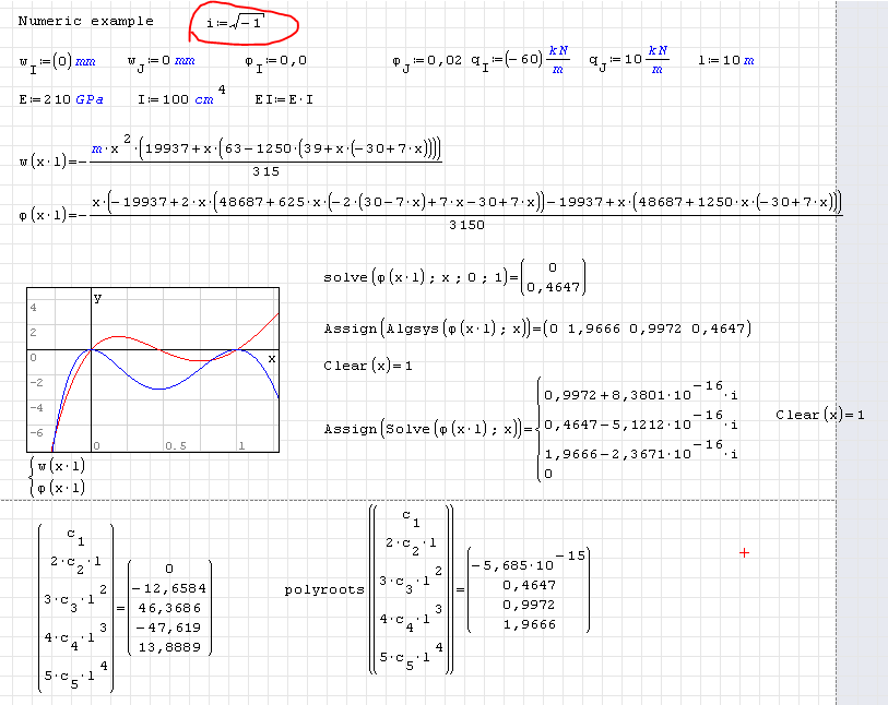

#33 Posted: 9/26/2014 2:45:35 PM
I tried to use polyroot, without success.
Probably I'm wrong in a way.
I think the problem is in the insufficient robustness of the polyroots function. I don't know why for moderate coefficients and solutions this function has to crash.
Unfortunately, Solve() isn't reliable as well. Need to see if that is a maxima or translation issue.
That sounds for me like a pro for the brute force approach. If the smart approach is not reliable, then it is useless. One might end up with a nightmare of checks and workarounds.
Edit: The Solve function is not to blame. The problems resulted from i being re-defined in the upstream sheet, thus the complex part of the solution was displayed wronly. By assigning sqrt(-1) to i the problem is solved. I just ignored the survival rule "Do not change i". But the temptation is strong to use i in loop counters...
Anyways, the function Algsys() seems more appropriate for root finding of polynoms. It has a slightly different output format, which is more of a glitch than by design.
ioan92 9/26/2014 3:33:00 PM
#34 Posted: 9/27/2014 4:59:55 PM
Ryan Freund
Ryan Freund
